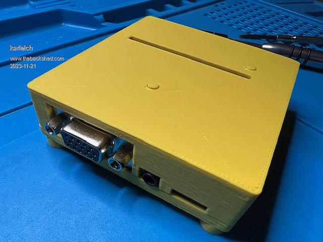

I created a simple 3D-printable case for Peter's PicoMite-VGA board v1.0 using FreeCAD.
It requires:
- 1x case top
- 1x case bottom
- 2x "button sticks" (to press the two buttons on the PCB)
- 4x feet
- 4x M3 machine screws
- 4x embeddable brass nuts (M3x8x5)
The FreeCAD file as well as the .STL files for the 4 printable parts are in here:
picomiteVGA_case_v2.zip
Here are some pictures:

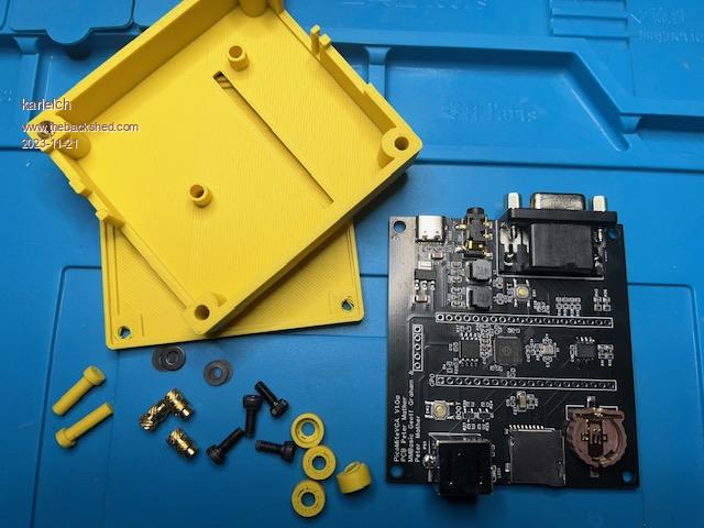

All parts:

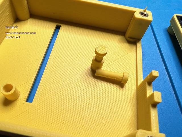

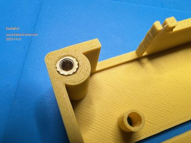

Embedded nut:
"button sticks":

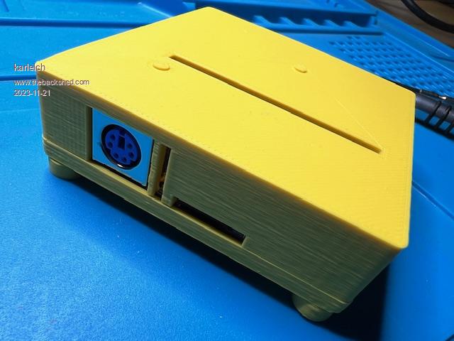

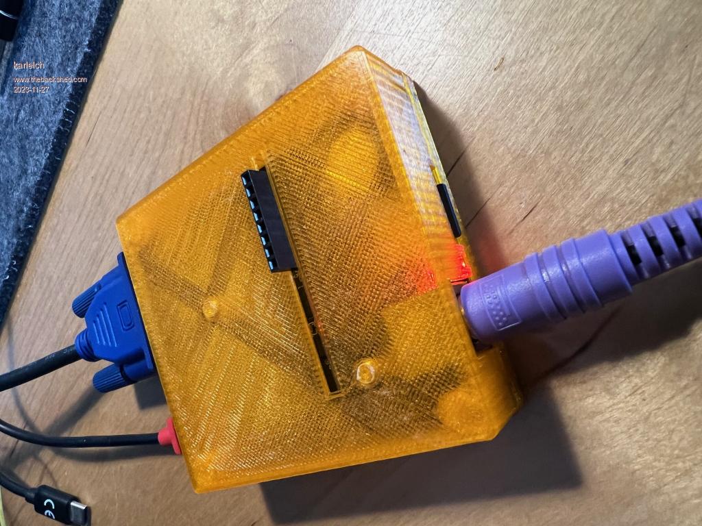

Finished case from one ...
... and the other side.
Thomas
