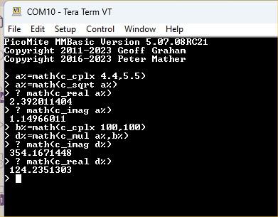

For fun I've added a complete implementation of complex numbers to a test PicoMite build
PicoMite.zip
In this implementation complex numbers have a 32-bit real and 32-bit imaginary part and to make this work in MMBasic I am using integers (64-bit) to hold these
Supported functions are:
complex% = MATH(C_CPLX r!, i!) 'create a complex
real! = MATH(C_REAL complex%)
imag! = MATH(C_IMAG complex%)
arg! = MATH(C_ARG complex%)
complex1% = MATH(C_ADD complex2%,complex3%)
complex1% = MATH(C_SUB complex2%,complex3%)
complex1% = MATH(C_MUL complex2%,complex3%)
complex1% = MATH(C_DIV complex2%,complex3%)
complex1% = MATH(C_POW complex2%,complex3%)
complex1% = MATH(C_CONJ complex2%)
complex1% = MATH(C_SIN complex2%)
complex1% = MATH(C_COS complex2%)
complex1% = MATH(C_TAN complex2%)
complex1% = MATH(C_ASIN complex2%)
complex1% = MATH(C_ACOS complex2%)
complex1% = MATH(C_ATAN complex2%)
complex1% = MATH(C_SINH complex2%)
complex1% = MATH(C_COSH complex2%)
complex1% = MATH(C_TANH complex2%)
complex1% = MATH(C_ASINH complex2%)
complex1% = MATH(C_ACOSH complex2%)
complex1% = MATH(C_ATANH complex2%)
complex1% = MATH(C_PROJ complex2%)
I don't pretend to understand all of these so you will need to google details of complex.h for more information.
There is no protection if you use the wrong datatypes for the functions.
If there is proper interest I may include these in the main firmware but only if there is a demonstrable use-case

I've added the following:
complex1% = MATH(C_POLAR radius!, angle!) 'NB: respects OPTION ANGLE
mod! = MATH(C_MOD complex%)
phase! = MATH(C_PHASE complex%) 'NB: respects OPTION ANGLE
PicoMite.zip
