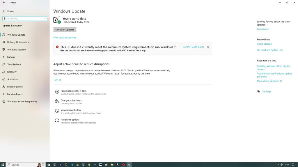

Posts: 2807
Posted: 11:28pm 26 Nov 2023
my win 10 pcs are not good enough. I'm happy with win 10 anyway.
linux is for experts. I got twisteros on rpi 400 and set to "win 10" but does "win 11 and 7" sort of. just eye candy, not win at all.
