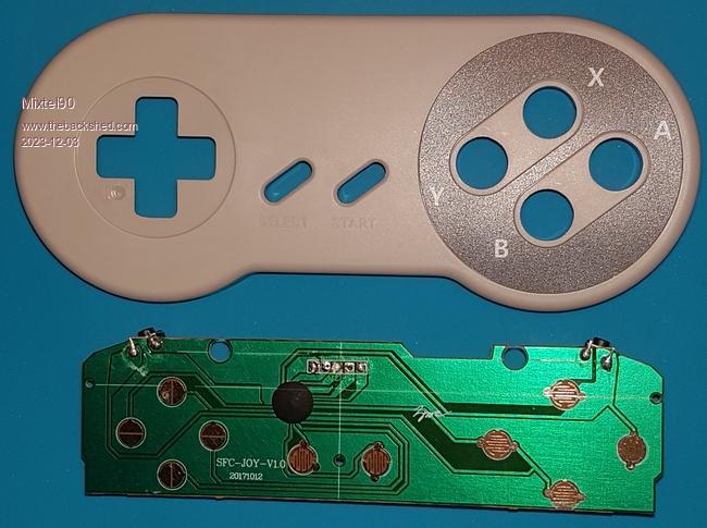

The cheap "SNES" controllers available from China aren't always what you expect inside. The cases seem to be reasonable, but the guts can actually be NES!
Tom asked if it might be possible to convert them into "proper" SNES controllers by swapping the PCB. I couldn't resist a challenge like that, so here's a naked SNES controller in all its glory.
A bit of examination reveals that the left trigger button is in parallel with Y and the right trigger is in parallel with X. These pairs share a common from the chip, the other sides coming from A and B, with more chip connections. One side of all other buttons (including A and B) are grounded. Some sort of multiplexing seems to be going on.
Connections from left to right are: VCC, GND, Latch, Clock, Data. In this case the wire colours are Red, Yellow, Green, Black, White respectively.
The PCB is single-sided and just over 1mm thick. The trigger switches are standard 6mm tactile switches with the connections trimmed off one side. The remaining connections pass through holes in the PCB and are soldered. Mouldings in the case behind the switches prevent pressure damage.
You may have noticed that I've scribed lines in the solder resist. I need reference                    points to get the hole positions right. I've spent quite some time on this today sorting the outline and some preliminary component positions out.

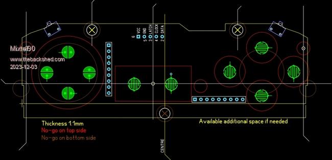

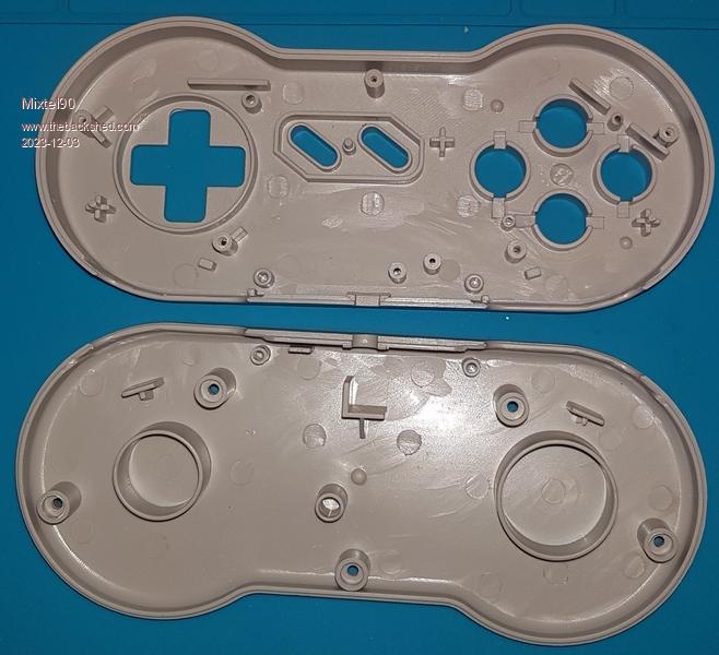

The case has plenty of mouldings in it to give support to the thin PCB under the action of high pressure fingers! There are no-go areas on both the bottom of the board, where you'd expect them, but also round every set of switch contacts.
It looks like it might just be possible to do a through-hole design if components are mounted on the bottom side of the board. There is more height there (between the two big tubes in the bottom moulding). SMD on the other side might be more of a challenge.
This is the basic PCB that we can work from:
I've put the trigger switches on and tentative positions for two 8-way commoned resistor packs. I've done the drawing SL6 rather than CAD as that's where I'm going to need it and I can't directly convert between them. It's a pity because using CAD for this would have been easier.

I have one of these open on my desk and the internals are slightly different. The two large circles in the bottom shell are the same size (the smaller of your two, I think,) bosses are a bit different and the pcb (with white drop chip) is a simple rectangle, 109mm x 37mm. I'll post some photos later.
Posts: 9036
Posted: 06:48pm 03 Dec 2023
I can't see this being a generic board swap, unfortunately. as I suspect there are many variations in the mouldings. Especially in the positioning of fixing and switch pad locating holes.

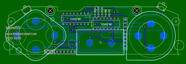

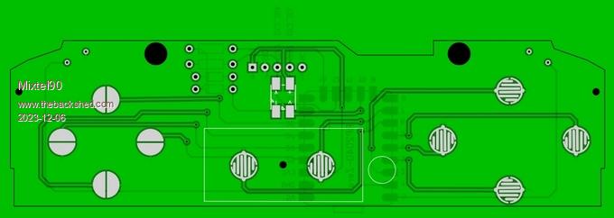

I now have two different approaches to the problem. The copper side of the PCB has far less height available than the bottom, but is OK for SMD. Both sides have the problems of obstructions either abo or below the board - or both!.
I don't mind this through-hole approach, but the space available for the resistor pack pins is tight.
I've cheated on both versions. The official(?) circuit uses separate pullups for each of the four unused inputs. This is pointless for CMOS inputs so I've used a single resistor. The three unused ones can be simply ignored after cutting their pins off. This saves on length. Alternatively five single resistors could be commoned up.
This is my preferred design, I think. I put the resistor packs on the bottom of the board again to avoid clashes with the flexible button pads. I think the SMD parts are also easier to get.

I'd let JLCPCB cut the shape out. I don't think it will affect the price much as there are no internal cutouts. I'll do some gerbers and see how they are for price. As the 4021BM (SMD) chips are cheap I might get a price for boards with those ready mounted too.
The bare board price for either option is £4.44 + postage + vat etc. for 5. That's cut to the silly shape. :)
I couldn't find a way to get a price with the SMD chips mounted (I'm not using EasyEDA). No worries, this package size isn't terrible.
