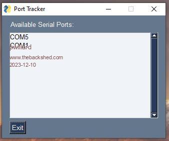

Posted: 12:33pm 10 Dec 2023
A simple python script can keep track of active ports...
# Name:
# Purpose:     Simple tracker for active serial ports attached to windows PC
# Author:      Pete Willard
# Created:     15/08/2023
# Copyright:   (c) willard 2023
# Licence:     CC BY-NC-SA
import serial.tools.list_ports
import time
import PySimpleGUI as sg
def main():
   layout = [
       [sg.Text("Available Serial Ports:")],
       [sg.Listbox(values=[], size=(40, 10), key="-PORTS-")],
       [sg.Button("Exit")]
   window = sg.Window("Port Tracker", layout)
   while True:
       event, values = window.read(timeout=1000)  # Auto-update every 1000 milliseconds
       if event == sg.WINDOW_CLOSED or event == "Exit":
           break
       refresh_ports(window)
   window.close()
def refresh_ports(window):
   ports = [port.device for port in serial.tools.list_ports.comports()]
   window["-PORTS-"].update(values=ports)
if __name__ == "__main__":
   main()
Could be modified to show Device ID, if you really wanted it I suppose.

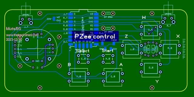

Posts: 9393
Posted: 12:46pm 10 Dec 2023
Hmmm....
My I2C controller (PZee Control) has the USB-C port in a good position to use it with a USB-C lead to a PC. Sending hex to the console should be fine. As I said though, it is just a PCB without a case.
Edited 2023-12-10 22:50 by Mixtel90
