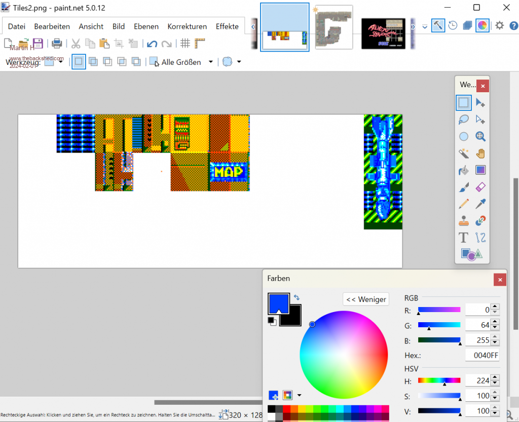

Since the sprites and tiles are not available on Github, this means that I have to draw everything from scratch.
Painting the whole thing from videos and screenshots is a very time-consuming task. Here is my worksheet of the last few days:
and a little Scroling Demo and Test of the Player-Animation

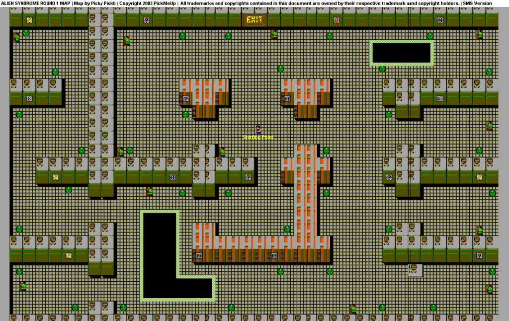

Did you find a "world map" somewhere ? I think the PETSCII ROBOTS gameplay is for a large part defined in the world map and it's associated tile atrtributes.
If that is available, we can re-use part of the PETSCII code, or at least use way it is implemented.
I found the Maps for the Levels but just as Pictures, so I have to draw the Tiles and then create the map files with a text editor based on the placing in the image.
like this Map1: (looks like the NES Version)
I think it could be a good way to use Excel for this Job using a Table with this Picture as Background.

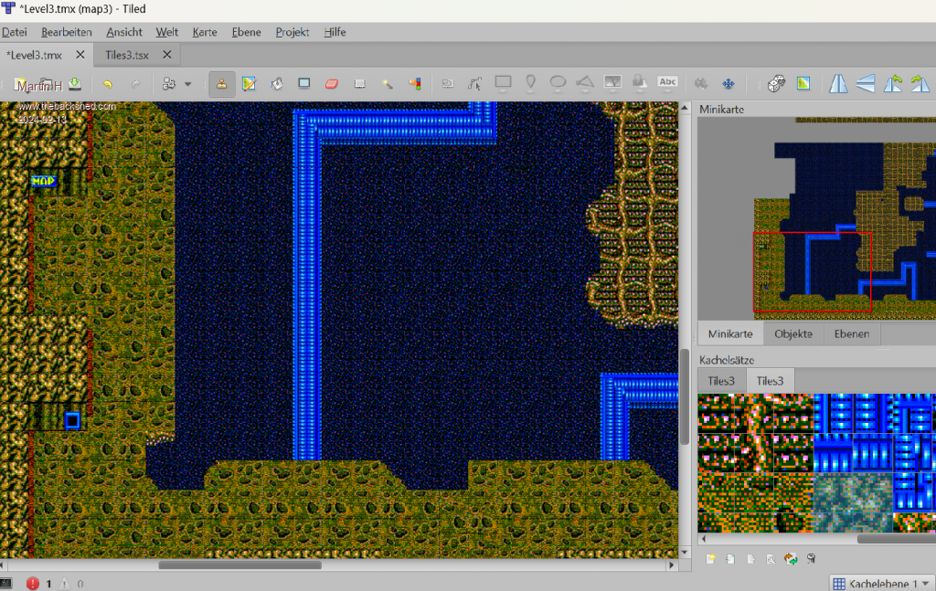

After pixelpainting most of the Map1 Tiles, I think I finaly found a usual Tile Map Editor
Tiled, a flexible 2D level editor for games.
Two advantages that I have discovered so far, 1. you can change the tile template with a painting program, then it changes automatically in the tile, so you don't have to reload it in the Mapeditor.
2. The map can be saved as a CSV file, which can later be easily converted into a PetRobot like format

LeoNicolas
Joined: 07/10/2020
Posts: 625
Posted: 03:56pm 21 Jan 2024
Hey Martin,
Tiled is the software I'm using to create the Knightmare maps as well. I wrote a small JS script (I have a python version as well) to convert the JSON to binary map-converter.js
How is the petrobot map format? I'm curious to know how the map data is stored

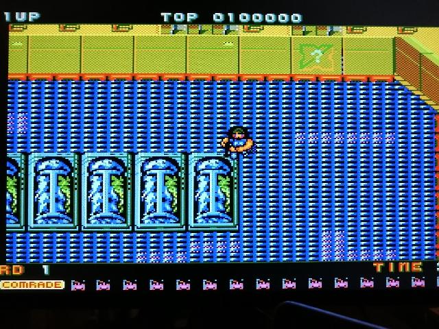

After I cut a march through video of the arcade version into single frames to get the MAP and the graphics. I'm about to create the tileset for MAP2 in RGB121 for the Pico.
You wouldn't believe how much time you can spend pushing pixels until you get a usable result

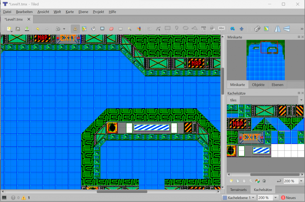

I managed to get 2 Level Maps ready and wrote a little MMB4W Program, which converts the TileEd exported CSV Files into Binary Map Files.
So here is another early proof of concept of the game mechanics.
Just a Demo, Interaction with the game is not yet available
AS02.zip
you can switch between the Levels by Changing the 1st Line
Dim integer level=1
to
Dim integer level=2
The tiles are currently stored in the framebuffer, as I have not yet converted them to CSUB and Lib File. In my opinion there are still changes and extensions necessary, which I still have to draw.
