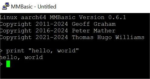

  [ said  QUOTE=toml_12953Can this be used (minus graphics, of course) over a serial connection to a terminal?
Here it is over putty:

Great! I have eight terminals running on my Linux box. I teach people programming and the class is very popular. I may need to add terminals. It's nice to know I can teach them a decent version of BASIC (No flames, please! I've heard all the arguments against BASIC but none of them holds water with a good, modern implementation.)

As @lizby demonstrated MMB4L is intended to be a well behaved Linux console application and you should have no problem using it via a (serial) terminal. If you do have problems then please let me know, it's probably a bug.

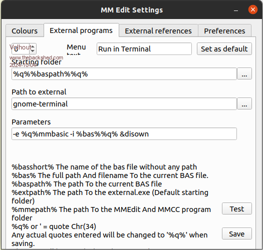

Tom,
In my effort to use MMB4L (0.6) on an Ubuntu system (22.04) I read through your README and there is all sorts of mention of editors.
Well, here is another one that is simple to use: MMEdit, the linux version.
1/ Install MMB4L as in the description (chapter #2 in the introduction).
When succesfully installed, you can open a Linux terminal window and type "mmbasic", and it will open MMBasic. You can "LOAD xxx.bas" and edit it and run it.
2/ Open MMEdit (assuming you installed it)
Go to "File" the "Preferences", select the tab "External Programs"
Change the filed called "Parameters" as below.
Save the change.

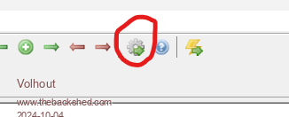

In MMEdit you now can select the desired syntax (MMB4L V0.6 is close to DOS syntax, but has some features from CMM2). So you can choose either. Note MMB4L 0.6 does not support graphics and sound yet.
When you press the RUN button, your program runs in MMB4L.
At the end of the run, you type "quit" to close the RUN window. This is on purpose, so you see error messages that would be invisible when the window closed premature.
