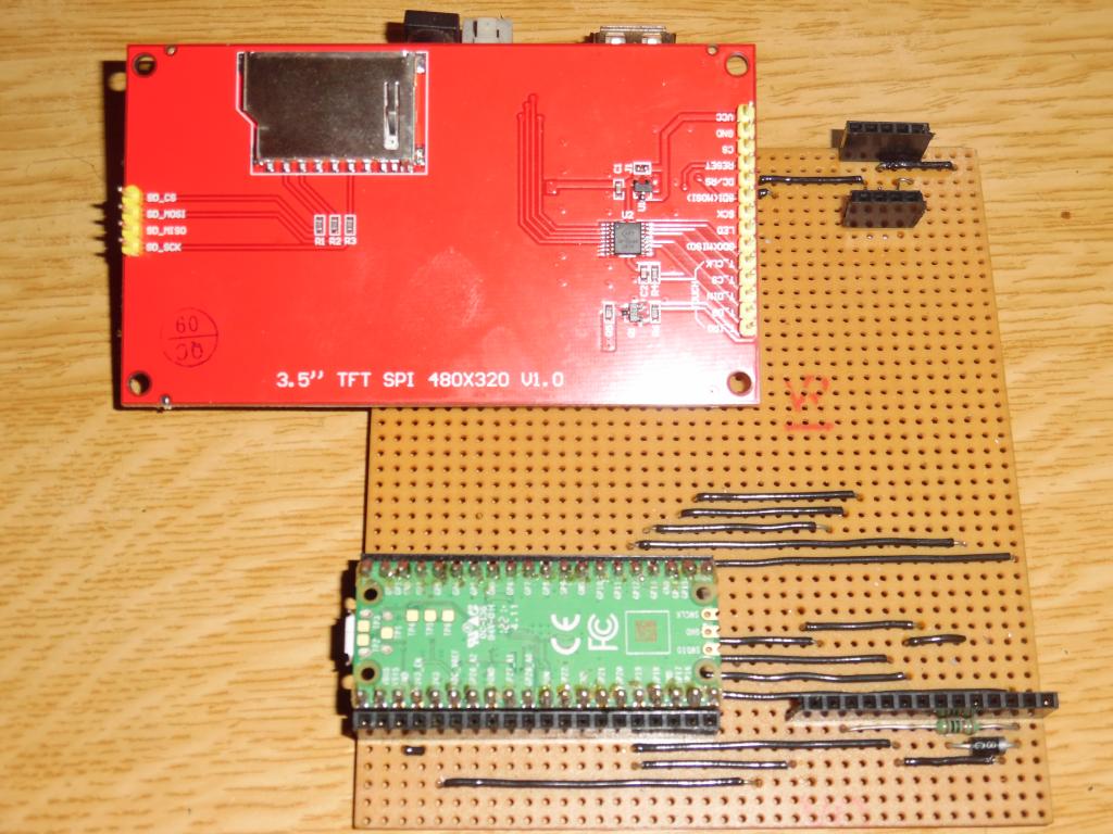

Hi,
I have problems with a ILI9488 and the onboard SD card holder, as well as with the touch.
I know that there are problems with the chip. That's why I have ONLY the card holder connected at the moment and still can't access my card.
What have I done:
- the 1K resistors in MOSI, MISO and CLOCK have been bypassed
- an additional 1µF was soldered between VCC and GND pins on the card holder
- a separate line for the power supply was soldered to the 1µF
At the moment, MISO, MOSI and CLC are only soldered to the card holder - no card is found despite this (I have tried several cards and card adapters) - Nevertheless, no SD card is found.
Before that, I had MISO, MOSI and CLK connected to the display and touch. First I connected MISO of the ILI9488 via a 680R, then disconnected it completely - no difference!
The display worked perfectly, the touch gives an error when calibrating by pressing the second point, the display itself always worked perfectly!
I operate the display with 3V3 and have set the jumper J1 to supply the card holder and the touch with voltage.
My display looks like this:
Currently only MISO, MOSI, CLK and CS are connected to the card holder via GP22. Nevertheless, the SD card does not work...

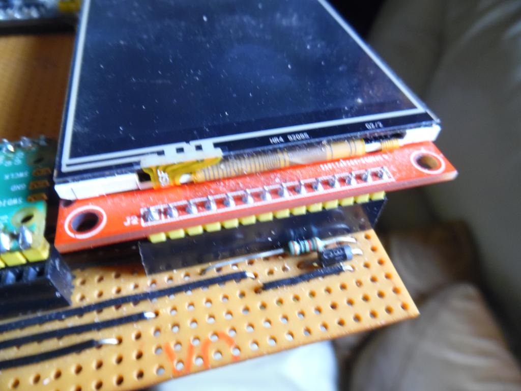

I used a diode and resistor as recommended on this forum.
Posts: 2807
Posted: 08:34pm 26 Feb 2024
same display, touch calibrated and card reads

To rule out the display as a problem, I have currently only connected MISO, MOSI, CLC, VCC and GND to the card holder and measured all the lines. Nevertheless, I still can't access the SD card and get the error that no card is inserted...
Can you give me a link to your diode conversion?
Frank
UPDATE:
I have now soldered on a completely different SD card holder
=> Error : SD Card not found
Damn it again, why doesn't that work????

Posts: 9035
Posted: 08:34am 27 Feb 2024
Where did you connect the new holder?
The one on the display has series resistors on it. These often cause problems and may need to be shorted out when using the display with a PicoMite. his only seems to affect some SD cards, others seem to be ok with them left in circuit.

Frank N. Furter
Joined: 28/05/2012
Posts: 1147
Posted: 09:34am 27 Feb 2024
Ok, I've finally found the error!
After checking the circuit for what felt like the 100th time, I realized that I had connected MOSI to the wrong pin on the PI!
(I had already checked this so many times...)
Now I know again why the four-eyes principle is so good! It's just stupid when you only have two eyes...
I still had to replace the resistors R1, R2, R3 with 0R and the 680R modification on the display did not work. The card access did not work with the three resistors or even with the 680R.
The modification with the diode ( https://www.thebackshed.com/forum/ViewTopic.php?FID=16&TID=11419&LastEntry=Y#194465#194399 ) then worked very well!
(Thanks to stanleyella for the hint!)
Now I just have to find out why the RTC is not recognized!
Frank
