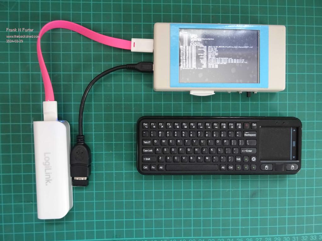

I've always wanted to have a small, portable BASIC computer. Here it is now:
The device should be able to run for approx. 22 hours with the power bank shown. The current consumption is approx. 80-90mA@5V.
The computer has three micro USB ports:
- Keyboard (or hub)
- power
- PC via TTL-USB (it can also be supplied with power via this)

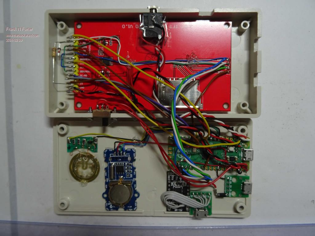

I used an ILI9488 with touchscreen as the display. To do this, I had to insert a 1N4148 with a resistor in the MISO line, swap the series resistors in front of the card reader for 0R and set the solder jumper J1.
It has a separate power switch for the USB power socket and the heartbeat LED has been led out. The internal LED was removed and the series resistor was increased from 470R to 4K7. The Würth 3mm LED (151033GS3000) still shines almost too brightly! Unfortunately, the LED is not on in all the pictures at the moment I pulled the trigger.
A DS1307 RTC and a piezo buzzer are also built in. Unfortunately, the buzzer sound is very high and very quiet.
The SD card holder is accessible from the outside. Today I received shortened card adapters - unfortunately they were squashed so much during transportation that they don't work properly (the internal contacts were pressed flat...)
GP0 and GP1 are accessible via a 3.5mm stereo socket.
I installed all this in a TEKO SR31.7 housing. The case was far too expensive at €14.71 and the screws supplied are too short!
Unfortunately, I have not found any other housing with these dimensions...
It doesn't look so nice from the inside, but it works:

Nice. I like it. Wireless USB keyboard makes a nice feature (if one doesn't expect to do too much typing on it).

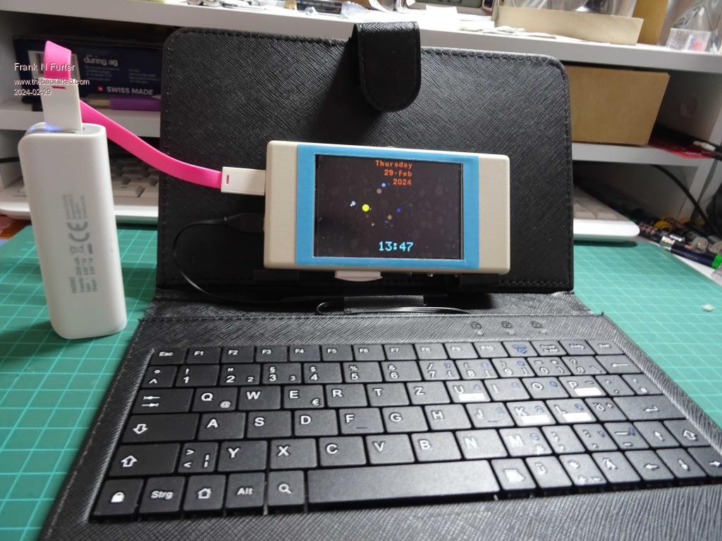

Hi Frank,
Just noticed the version of Solar System you are using is for a 320x240 display, if you prefer I attach one scaled for 480x320. If you haven't enabled backlight brightness, you will need to comment out all lines setting brightness.
Regards Kevin.

@Bleep:
Thank you very much! I happened to have the 320x340 version on the SD card and it worked straight away.
My options are:

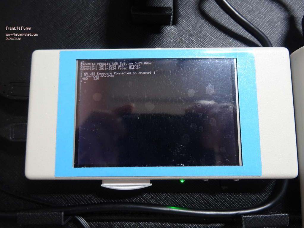

Frank--can you post the result of ?mm.hres,mm.vres
Can you provide a link to where this particular ILI9488 is sold?

480x320, not, as per the other thread, "a USB Picomite with a 320x240 ILI9488 display."

  lizby said  Frank--can you post the result of ?mm.hres,mm.vres
(This time with an illuminated heartbeat LED   )
  lizby said  Can you provide a link to where this particular ILI9488 is sold?
Unfortunately not! I bought the displays via EBAY. It was a private individual who only had two left...
But they are available on EBAY if you search for ILI9488.
Frank
Posts: 3885
Posted: 01:14pm 01 Mar 2024
Thanks, Frank. 480x320. I have several ILI9488s with that resolution--bought on Aliexpress. I was wondering because the other thread had started off with mention of an "320x240 ILI9488". I thought that was probably a mistake--thanks for the confirmation.
