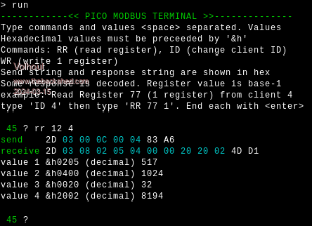

Hi All,
This is by no means a complete project, it is a tool I needed for my job, and since the IT department is very restrictive on open source tools (read: cost = 0) installed on the companies computers, I hacked together a tool that uses a pico to connect to a modbus client.
MODBUS TERMINAL
The program uses a standard picomite (non-VGA, although it will run on a VGA) and should be controlled from a terminal program like PUTTY or TERATERM.
It uses ANSI colors to highlight the PDU (the payload).
I have implemented only the commands I need for this project. That is READ HOLDING REGISTER and WRITE SINGLE REGISTER but other commands can be added when needed.

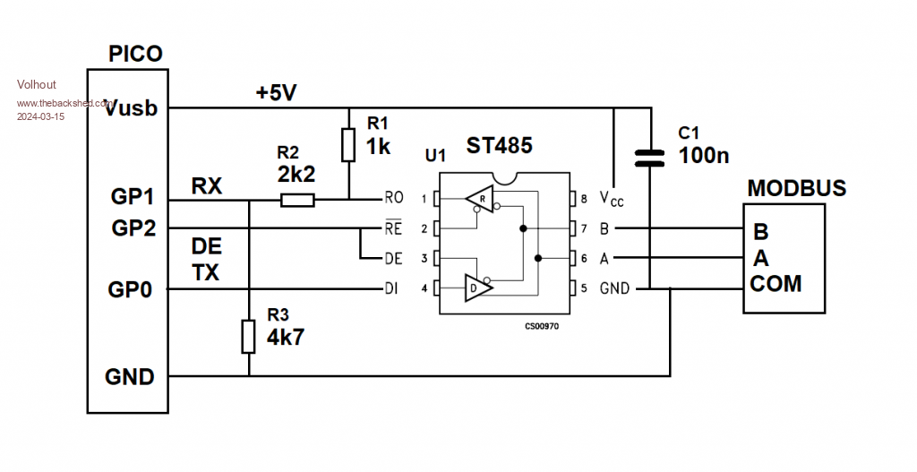

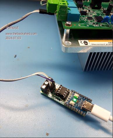

The hardware interface is this (I only had a 5V RS485 interface chip, if you have a 3.3V capable chip you can ommit R2 and R3). For long cables you want to add a 100 ohm  resistor (termination) between A and B. But for my bench test this is fine.
The program is attached. I originally wanted to use interrupts for the receive side, but at higher baudrates this caused too many delays (since I control the DE pin from MMBasic). It is tested up to 115200 baud (default is 19200).
I hope this is to someones use....
P.S. In my version, mor commands are implemented, but these reveal customer specific information, like the way to use a password to get into factory settings. These are removed from the version below.

sub helptext
 print gr$+"------------<< PICO MODBUS TERMINAL >>--------------"
 print "Type commands and values <space> separated. Values  "
 print "Hexadecimal values must be preceeded by '&h'"
 print "Commands: RR (read register), ID (change client ID) "
 print "WR (write 1 register)
 print "Send string and response string are shown in hex"
 print "Some response is decoded. Register value is base-1"
 print "example: Read Register 77 (1 register) from client 4"
 print "type 'ID 4' then type 'RR 77 1'. End each with <enter>"
end sub

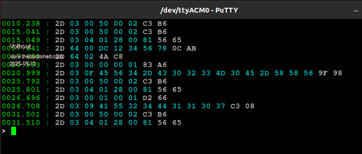

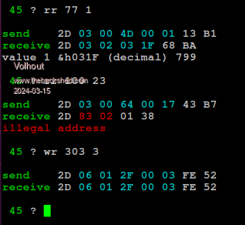

This is an updated version of the MODBUS RTU terminal.
- When PicoMiteVGA then the VGA screen is used as terminal
- When PicoMite then Teraterm/Putty is treated as the terminal
- Implemented write to multiple registers (WM) and write of a string to a single register (WS).
This is the code.

 Print "-----------<< PICO MODBUS RTU TERMINAL >>-------------"
 if vga then color rgb(white) else print wh$;
 print
 Print "Type commands and values <space> separated values."
 Print "Hexadecimal values must preceeded '&h'. Commands :"
 Print "ID (change client ID)     = ID xx "
 Print "RR (read registers)       = RR reg num"
 Print "WR (write 1 register)     = WR reg val"
 Print "WM (write multi registers)= WM reg num val1 val2 .."
 Print "WS (write text string)    = WS reg TEXT_STRING"
 Print "Send string and response string are shown in hex"
 Print "Some response is decoded. Register value is base-1"
 Print "example: Read Register 77 (1 register) from client 4"
 Print "type 'ID 4' then type 'RR 77 1'. End each with <enter>"
end sub

Up to now I used a PicoMiteVGA for the job. For field work, I created a adaptor cable for the laptop, using a RP2040-ZERO and a RS485 interface chip.
Use TeraTerm or Putty, since these support the ANSI colors in the terminal window.
The WS2812 LED on the zero shows status
GREEN = OK
CYAN = waiting for answer (no response)
RED = MODBUS failure
Code:
modbus12.zip
Photo of actual interface before sleeving:

Snoopy is a modbus spy. You connect it as a device to an existing MODBUS RTU system, and it lists all traffic on that bus. It is not sophisticated, but just does (only) that.
Snoopy runs on a picomite. Connect a 485 driver chip (i.e. MAX485) to COM1 of the pico (GP0/GP1) and connect RE and DE pins to GP2. Same as shown in the first post.
The code is simple.

I used a RP2040 ZERO that has an on_board  WS2812. It changes color with the messages on the bus. CRC fails are indicated. If you have a genuine pico, comment out the WS2812 lines.
The console messages show errors in the communication in red color. Traffic analysis is not implemented (yet).
