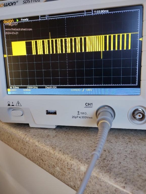

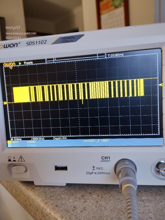

Using the ArmmiteF4 with MM V5.07.02b2.
@phil99 coded  NECSend for the Picomite using MM.
Const IRpin = MM.Info(pinno gp1)  'output pin, change as needed
SetPin IRpin, dout : Pin(IRpin) = 0 ' IR code output
'Your program here.
Input "Enter Device and Key codes "; dev, key
NECsend IRpin, dev, key
Sub NECsend IRpin As integer, dev As integer, key As integer
Local integer word, d(2200), m, n = 1
word = (dev<<16) + (key<<8) + ((255 Xor key )And 255) 'assemble 32 bits
Math set 13 , d() '13=1000/(38*2)uS duration of a half cycle @ 38kHz
d(672) = 4500  'pause after start pulse train
For m = 714 To 2100 Step 42  'load data after start sequence
  d(m) = (((word>>(32-n)) And 1)*2 + 1) * 562.5  'convert bits to duration (short = 0, long = 1)
  Inc n 'step to next data bit
Next
Device bitstream IRpin, 2199, d() 'send the data
Pause 100
Pin(IRpin) = 0
End Sub
This works for an Onkyo receiver. (Also with 'Device'command replaced with Bitbang)
The above code with the IRpin changed to (pinno PE0} on the ArmmiteF4 does not work.
After investigation it appears that "d(672) = 4500  'pause after start pulse train" is not interpreted by BITSTREAM.
It shows up in the d(0) to d(800) bitstream exactly the same as the picomite but does not result in the 4.5mS space after the leading pulse burst.
test values are devicecode  19832 keycode 192.

Your scope pics indicate all the bitstream array index values are off by 1 anyway. It doesn't affect anything I have but I will tidy it up anyway.

The bursts are 42 cycles of 13us = 546us (not exacly 562, but close)
The pauses between the bursts must be 562us (logic 0) -or- 1686us (logic 1).
Look at both scope plots. Either the burst timing is wrong, or the pause timing is wrong. Visually there is simply too much burst visible.
Checkif a single cycle is 13+13=26us. It feels the burst is 800us, in which case 13us is more 20us, 38kHz is 25kHz.
P.S.... this feels like a job for PIO. Shift the 32 bit NEC value in FIFO, and let PIO do it's job. But I guess this is for the F4. No PIO.

The apparently wrong timing pointed out by Volhout are correct on my scope and the Sub works on my devices.
Perhaps a display artefact in the images?
