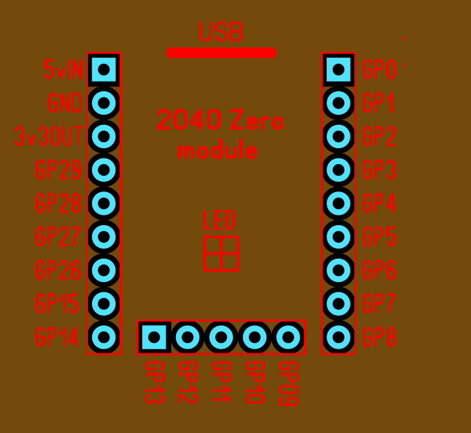

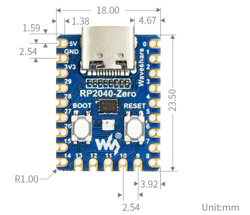

I have Grogster-Graeme's but it doesn't seem to jibe with what I see on the Waveshare 2040-Zero datasheet. Is there more than one design?

Mine are almost like your photo, although they are not Waveshare branded. Note that the bottom row from 14 down to 8 are all on 2.54mm centres and that you can't easily surface mount this board as the RP2040 is mounted on the bottom.
I have this drawn out as an SL6 macro if you'd like it.

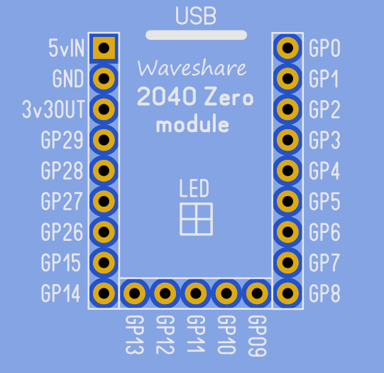

Thanks Mick, I was sure that you had one because it was the Sweetie-Pi that made me look at Grogster's macro.
I modified his to this (which I think is the same as yours). Grogster's has different spacing between the side-holes and the bottom row:
This is all 2.54mm. Should be good, right?

Should be fine, yep.

Hi - that first image looks like it was not quite right, and as you say - does not really fit the module.  I suspect it made it into the makroes pack, as an early one, cos the correct one is the modified one, and yes - all on 2.54mm grid, but not suitable for breadboard mounting unless you leave the 5-pin header off.
An example of my use of the module on a board:
