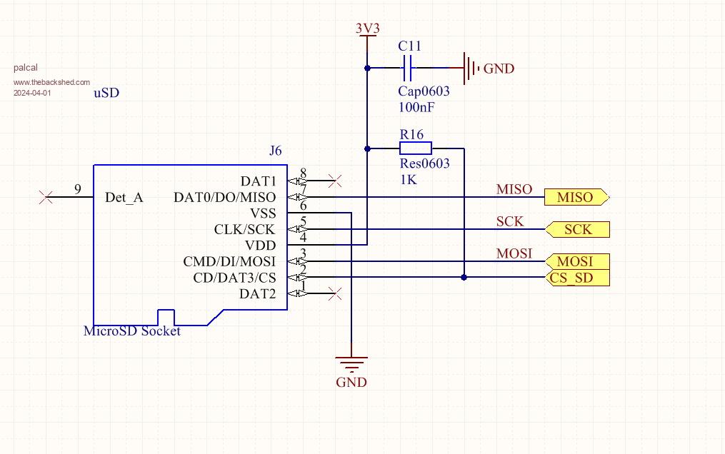

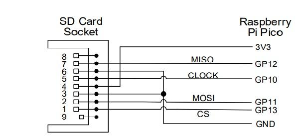

In the manual on page 17 the pinout is shown and pin 1 is CS however in all the pinouts I can find pin 2 is CS...
So what is the correct pinout. I just had a batch of boards made using Pin 1 for CS as per the manual and I get an error SDCARD not found.
The Pinout in the manual also has Pins 3 and 6 going to ground. I looked at the circuit for the Pico Backpack in Silicon Chip and Pin 2 is CS and there is only one pin going to ground.

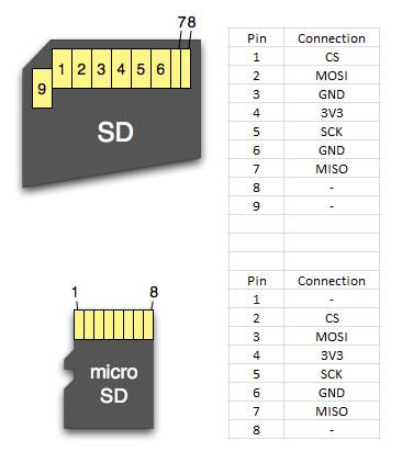

Posted: 07:51pm 31 Mar 2024
Does this help?
Your diagram illustrates the pinouts for a micro-SD card; the diagram on page 18 in the Picomite manual is for a standard SD card.

Posts: 2807
Posted: 08:00pm 31 Mar 2024
page 17 in the manual is connect to sd card direct. different
Posts: 9036
Posted: 08:05pm 31 Mar 2024
As I said, that's for a full size SD card. A micro SD card is different.
palcal
Joined: 12/10/2011
Posts: 2046
Posted: 08:38pm 31 Mar 2024
I never gave that a thought, oh well the boards are still useful just not with an sd card. I'll re design the board, not the first time I've got a batch of boards with a mistake.

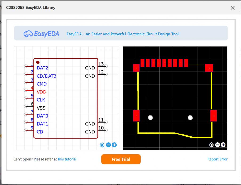

Posts: 11753
Posted: 08:38am 02 Apr 2024
Of course, if you used EasyEDA you wouldn't have these problems. When you hover over the pin in the layout it gives you the name assigned.
The models in the LCSC part catalogue are in general excellent and by starting from the schematic you know you have got it right every time
