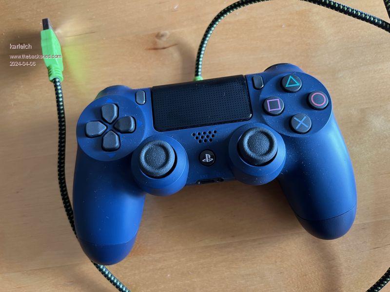

A small Basic program to test gamepads (I tested it with the PS4 controller as well) you can find here: gamepad_test.bas

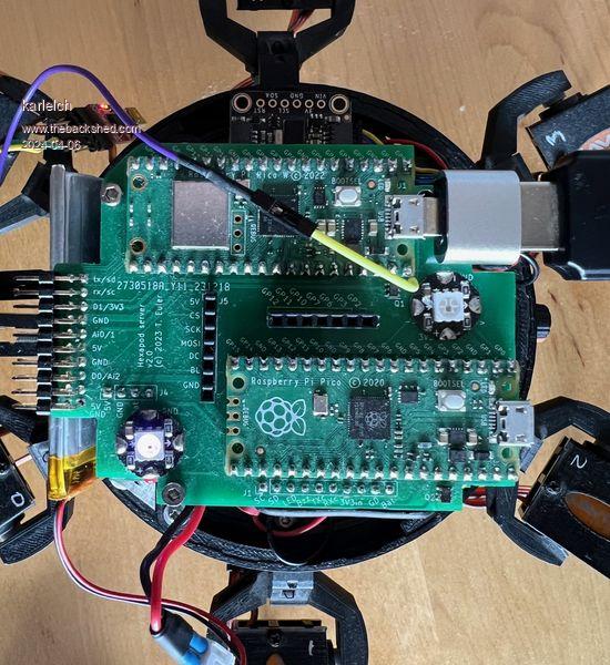

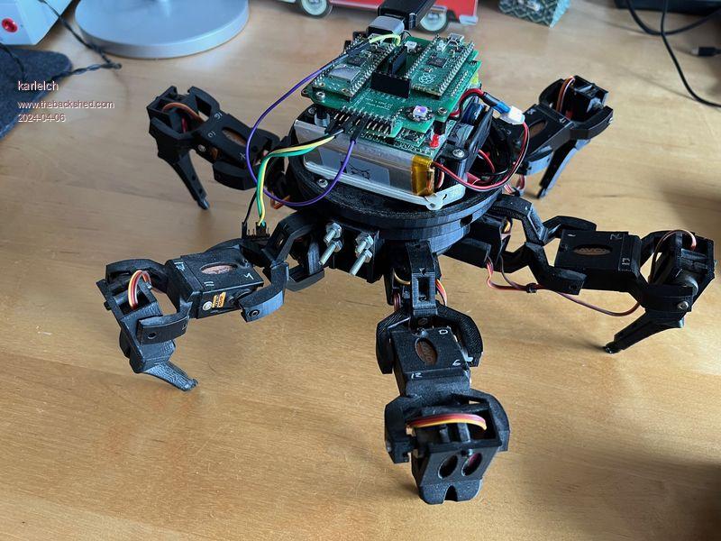

The robot is one of my long-long-term projects (one can see that from the dust on some parts ...   ).

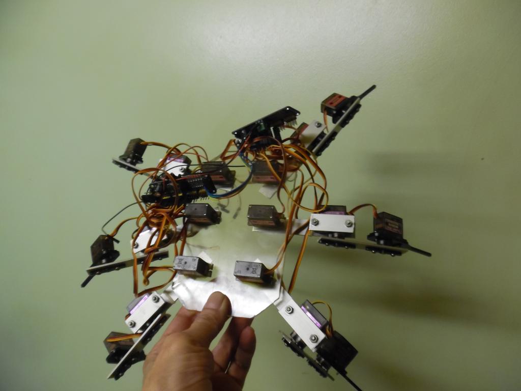

The mechanical setup was inspired by the remote-controlled Arduino-based vorpal robot, but with one more joint per leg added.
Its 18 servo motors are controlled by a Maestro 18, which receives commands from one of two Pico (W) microcontrollers. They both run MMBasic, one -- the server -- controls the gait and generates the leg movements, the second one -- the client -- currently receives the gamepad input and talks to the server via a serial connection. Eventually, the client will control the robot autonomously.
Other features are:
- 8-channel servo-load sensing
- BNO055-based 9-DOF IMU
- two WS2812 LEDs for signalling the robot's state
- a TFT display (not mounted here)
- a buzzer
- separate logic and servo batteries with voltage monitoring
- hardware handshaking between the Picos
- a potentiometer for mode selection (not yet used)
Originally, I developed MicroPython code for it but gave up at some point, because it did too much in the background (e.g., garbage collection) and that kept messing up the servo update timing as well as the communication between the two "brains" ... Newer MicroPython releases may be better with that now, but I was wondering if a solution with MMBasic running on "bare metal" on a Pico would be better. And indeed, it runs very well and reliable, the communication between the Picos is a dream.
And if the timing is too slow, I just overclock it more
Finally, here's a video,
I'll document the hardware and the MMBasic code soon in the repository - in case someone is interested.

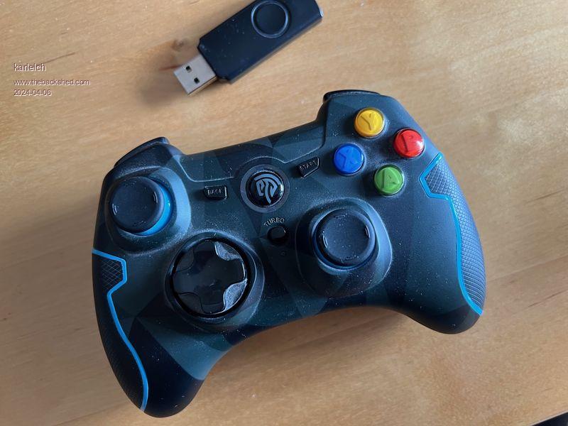

Of course, you can add it, however, I am not sure how useful that is for others. I bought it 4 years ago to work with my Windows PC, which is does well. It is from a company called EasySMX (PS3 Controller, EasySMX 2,4G Wireless Gamepad, Joysticks Dual Vibration TURBO) and it can work in different modes:
Note that it is not really "XBox" - I gave it that name in the code before I figured out  what it really is. Depending on the mode, it returns different vendor/device ID combinations and data packages:
"Android", vendor ID: 0x11c0, product ID: 0x5500
"X-input", vendor ID: 0x045e, product ID: 0x028e
"D-input, emulation", vendor ID: 0x11c1, product ID: 0x9101
"PS3", vendor ID: 0x054c, product ID: 0x09cc
When connected to a Windows 11 PC, all modes are recognized.
For the PicoMiteUSB, "PS3" would have been the obvious choice, by just adding another device ID to your `is_sony_ds3()` function, but for some reason that did now work. This is the controllers default mode. When it is started, it behaves like a PS3 controller. But then changes mode, if no PlayStation responds (I guess). This is probably why the PicoMiteUSB firmware was not able to stay connected.
"D-input, emulation" works but generates very long (27 byte) data packages that contain all relevant data (some redundantly).
"Android" generates nicely compact 9-byte data packages, providing data about almost all buttons and joy sticks that your firmware supports, therefore I opted for this format.
To cut a long story short, I think it would be great to add another type of controller/gamepad, but I am not sure which format. Maybe that "Android" format, that I mislabelled in my code as XBOX. However, I don't know how common that is.
As to the wireless: I expect that Gamepads that use a special dongle (like the one here) should generally work - if their IDs/data format are known and they make it through the "negotiation phase". All newer wireless gamepads seem to rely on Bluetooth and are therefore out of the question.

karlelch
Joined: 30/10/2014
Posts: 361

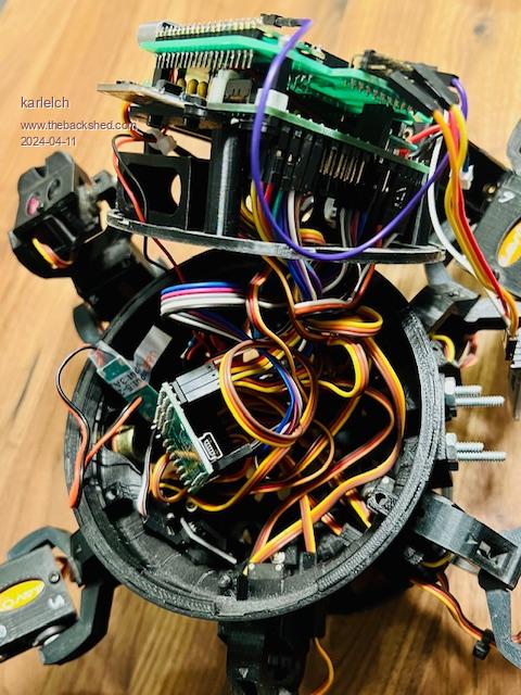

Posted: 08:28am 11 Apr 2024
Burned out servo   ... surgery required ...
