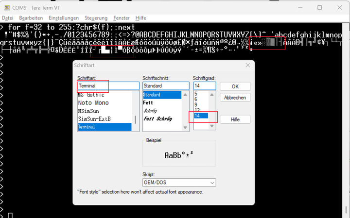

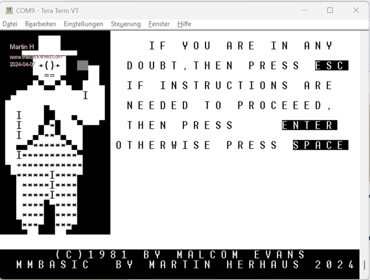

a playable Version of ZX81 Classic 3D Monster Maze for PicoMite, Running in a VT100 Terminal (TeraTerm)
For the correct representation, pay attention that your terminal program uses a font that contains the graphic symbols in the range above 128.
Especially CHR 176-178, 219, 220 and 223 are important here.
I Use a Font called TERMINAL

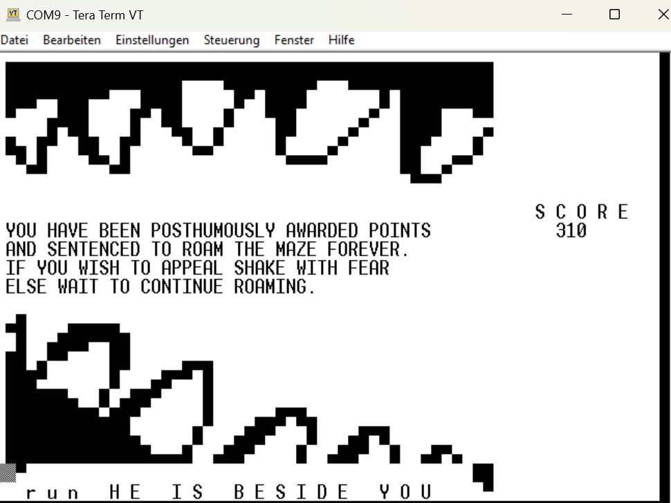

Hi Martin,
Nice !!
Did you even reach the exit of the maze, or where you eaten every time ?
Is there a strategy, or is it not possible to reach the end ?

Yes I reached the exit of the maze. But it is difficult (as it was on the ZX 81 too) and it runs faster than the original. Rex runs only half as fast as you do, but of course you have to react immediately.
Is there a strategy?
For orientation: You always start at the bottom right, facing left, the exit is in one of the top 6 rows.
You might extend the Pause 250-(Timer -tt%) in the main loop to give you more chances.

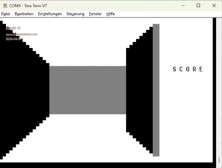

You use two variables trex.x and trex.y without declaring them, are perhaps typos and supposed to be rex.x and rex.y, without the 't' ?
Martin H.
Joined: 04/06/2022
Posts: 1574
Posted: 12:05pm 28 Apr 2024
  thwill said  Hi Martin,
of course, You're right, my typo.The variables should be without "t". Fortunately, this only affects the messages REX HAS SEEN YOU, not the game mechanics.

A couple of other observations from watching videos of the original:
- the score should increase by 5 every time the player moves.
- a horizontal wall in the far distance should be rendered in black.
