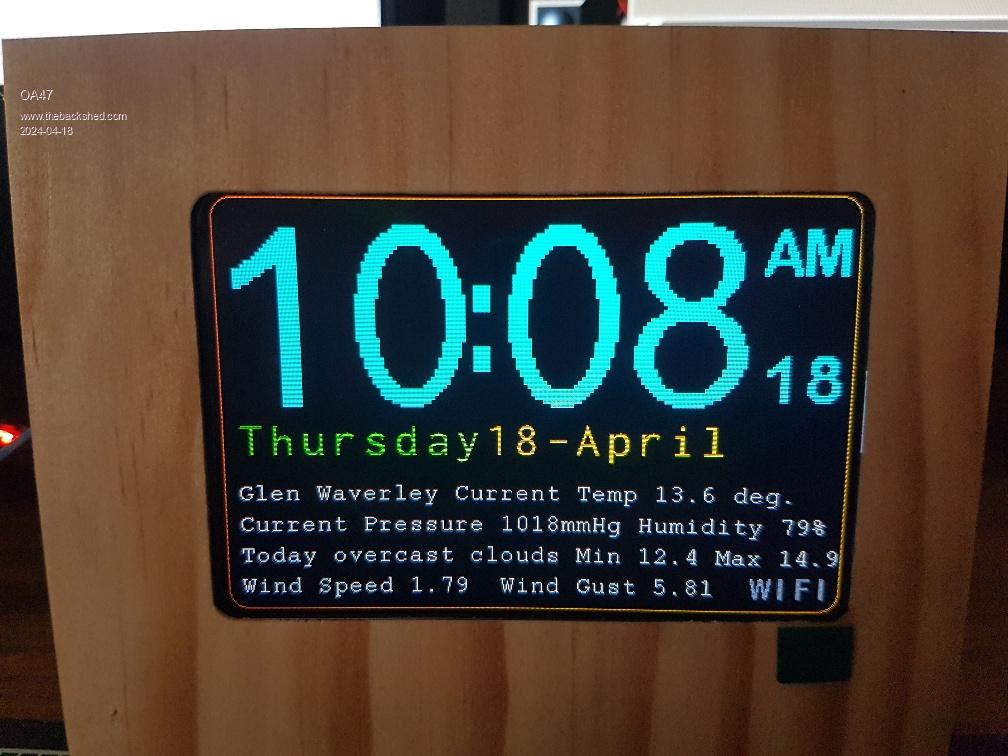

OA47
Joined: 11/04/2012
Posts: 1050
Posted: 12:14am 18 Apr 2024
NPHighwiew,
  Quote  This looks like a very nice addition to a digital clock app, now that you've worked out the bulk of the bugs :-)
Is this what you were thinking?
0A47
NPHighview
Joined: 02/09/2020
Posts: 222
Posted: 01:37am 18 Apr 2024
Almost exactly! I have an analog clock, patterned after Swiss railway clock face, and will be very happy to add this to it. It picks up UTP once an hour. I think picking up weather once every 5 to 15 minutes to stay well below the 1k per day charge limit.
