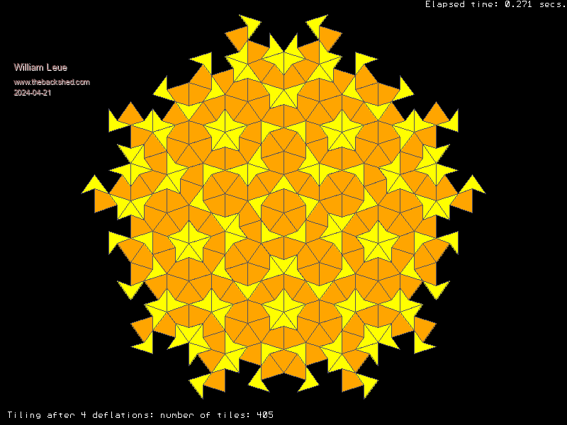

I wrote this some time ago but it needed cleaning up, which I finally got done.
You can generate Penrose P2 tilings starting from any of the 7 unique vertices, and choose a tile size and color scheme.
Enjoy!
-Bill
Penrose.zip

Hi Bill,
Did you try to run this at MMB4W, or only on CMM2 ?
It does not work immediatly on MMB4W , I may have to debug...
Posts: 6624
Posted: 10:49pm 22 Apr 2024
For MMB4W the main problem is detecting ENTER
In MMB4W the enter key returns LF not CR although that might vary from PC to PC.
To make it run, I added const LINEFEED = 10
and CASE ENTER, LINEFEED to the startscreen sub.
There are a few font sizes and MODE choices to make but with that one change, it does run on MMB4W

Thanks, Jim!  I do my best to make sure my programs run correctly on the CMM2. I do not test for running on any other hardware, sorry. I don't own the hardware to test it on, and I don't really have the time.
However, I am always glad when somebody takes up the porting job. I try to make my code easy to port  with liberal use of constants, comments, and in general good structuring.
