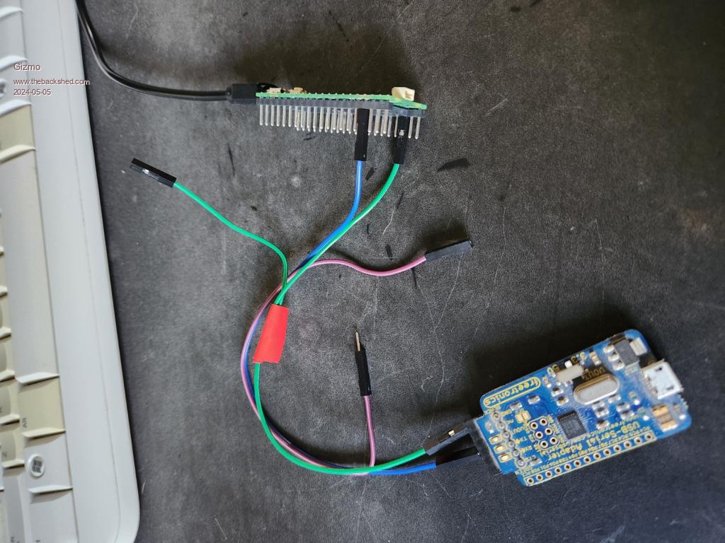

Ok, added a USB-Serial adapter, set for 3.3v, wired the adapter Tx to pin 17 ( GP13 ) of the PiPico. Opened a terminal to the adapters com port, I type letters, can see the Tx led flashing, and see the data going into pin 17 on the PiPico. The following program shows no data coming in

Another weird thing I discovered, this configuration below causes the Pi Pico to drop the USB ( maybe lock up or reboot )....
Now thats a serial to USB adapter, not plugged into anything. It's Tx line was connected to pin 17 of the Pi Pico, and the earths connected. Thats it, no other wires. After I did the "option system I2C disable", it's fine
