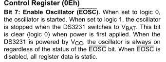

I have problems with the RTC DS3231. I set the time by entering it on the console with RTC SETTIME YYYY,MM,...and so on. This also works without errors. The option for I2C is entered, I have defined the I2C pins (GP0 and GP1).
In the program I query the time with RTC GETTIME. That works too. The only error is that the time I get here is the time at which I switched off the voltage on the RP2040 Zero. The RTC is obviously stopped and the battery in the RTC circuit ensures that the time is remembered.

The error appears as if bit 7 in the control register is set to logic 1 and the oscillator is stopped.
This is from the DS3231-manual:
Best wishes! Joachim

I have to apologize to you. I used the RTC DS1307 instead of a DS3231. I could have sworn it was a DS3231. I have lots of RTC in my craft box. I got the wrong one. With the DS3231 it now works without errors. Thank you for your support!

I had an episode with some very poor coin cells (yellow ones about 1cm across and the voltage would drop to about 0.6V when on load (i.e. with the main power off), which is way below VBat (min 2.3V) required to keep things running without Vcc.
In such cases, the internal oscilator will stop and the registers become static. Check Reg 0Fh bit 7... "A logic 1 in this bit indicates that the oscillator either is stopped or was stopped for some period and may be used to judge the validity of the timekeeping data. This bit is set to logic 1 any time that the oscillator stops. The following are examples of conditions that can cause the OSF bit to be set:
1) The first time power is applied.
2) The voltages present on both VCC and VBAT are insufficient to support oscillation.
case 2 was my problem - I think it might be yours too.
p.s. you have to reset the flag, it won't clear by itself.

After realizing that I wasn't using the DS3231 but the DS1307, I changed the modules but used the same battery. This means - as I wrote in the previous post - the RTC now works perfectly. In fact, the reason why the DS1307 did not work has not yet been found. It may be due to the weak battery. The DS3231 has enough voltage, the DS1307 may not. I also need to see if the DS1307 also has a control bit that can be used to turn off the oscillator.
The battery currently has an open circuit voltage of 3.07 V. Tomorrow I will test the DS1307 with a new CR2032.
