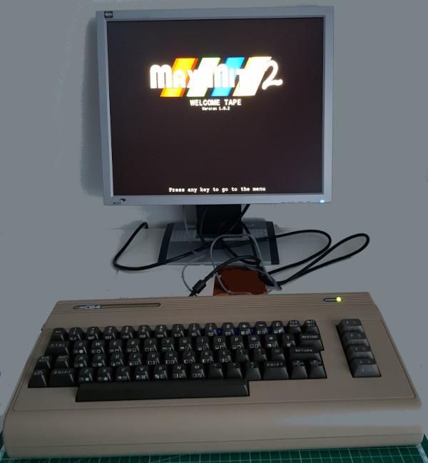

Hello,
Long time I struggled to find a proper housing for my CMM2 so I started to think about something extraordinary. Anyway, I need a proper keyboard because the CMM2 is quite picky with keyboards.
Then I stumbled over "The C64" and thought by myself: This would be a propper retro housing for my CMM2. So I did it:
The green LED indicated that the CMM2 is active. When the drive is accessed, the LED flickers in red.
If the LED shows permanent red, the build in C64-Emulator is active.
Both computers share the keyboard, which in fact is a USB keyboard. Unfortunately the keyboard layout deviates in many ways from modern keyboards, so I had to patch the firmware to get it right.
It's like a time travel 30 years back in time.

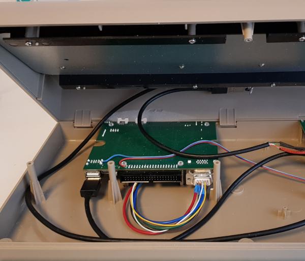

A look under the bonnet (shy persons should close their eyes now   ):
