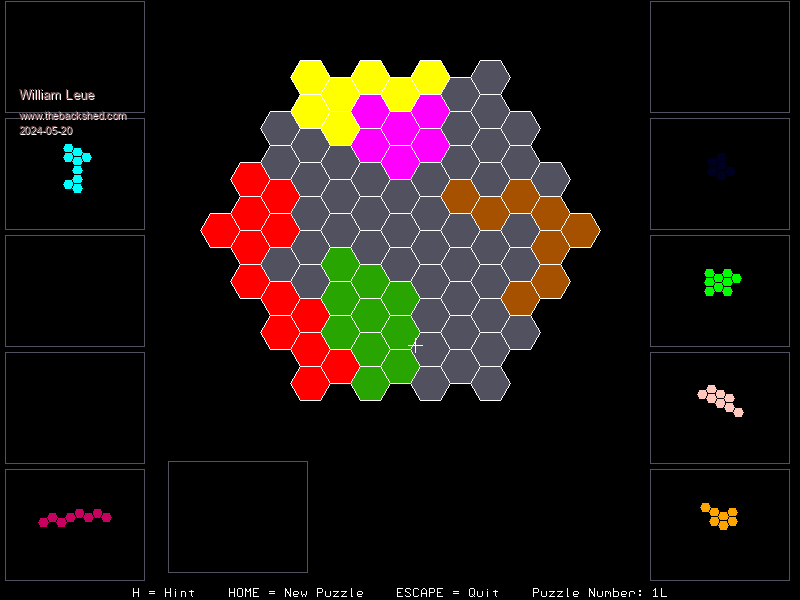

New puzzle program for the CMM2: requires a mouse, sorry.
The goal is to load the given partition segments into the hexagonal playing board until the board is completely covered with no gaps or overlaps. There are 60 supplied puzzles in small, medium, and large sizes. Plus, there is a program that you can use to make your own devilish puzzles!

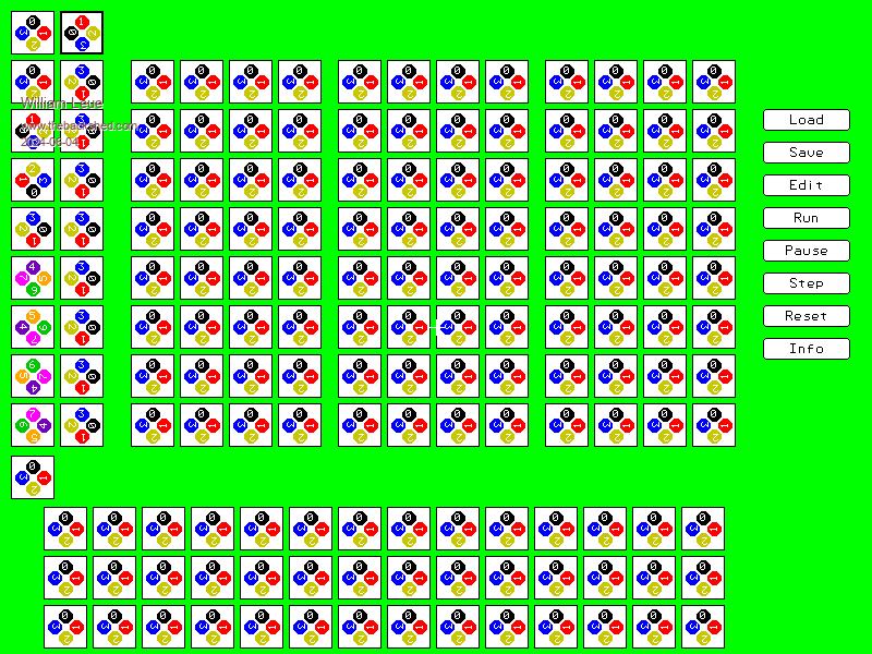

Lately I have been exploring mode 10 to get even more pixels on the screen. Here's a screen shot from a program I just finished. (I don't know if TheBackShed is going to reduce the size you see, but it's full size in mode 10.)
