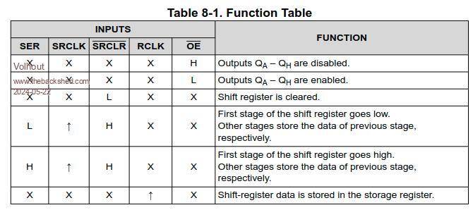

Posts: 5072
Posted: 10:11pm 21 May 2024
Andy,
Typically you can connect a 74HC595 to a SPI bus (even in combination with other SPI peripherals) and use the 8 outputs to drive the ULN2803.
And these are in DIL-16.
OE  =     low
SER =     SPI data in
SER_CLK = SPI clock
SRCLR =   high
RCLK =    latch pulse low-high-low to transfer data to output pins

Posts: 5072
Posted: 07:30am 22 May 2024
Hi Phil,
I missed this when you published it. Nice...
But there is already a SPI bus on the board. So using a 595 as SPI device look simple (you can even use the chip select (active low) to latch the data, since the RCLK (latch) line is edge sensitive...
So wire it like the MAX335, and send only 8 bits...
