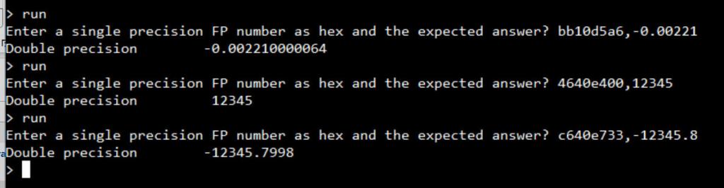

In another thread a reading from a sensor was returning a single precision floating point number.
This post shows how to convert this to a standard MMBasic double with a bit of of simple bit-twiddling.
Option explicit
Option default none
Dim w%,s$,c%,d%,e%,o%,a!,i!
Input "Enter a single precision FP number as hex and the expected answer";s$,i!
If Left$(s$,2)<>"&H" Then s$="&H"+s$
Poke word Peek(varaddr w%),Val(s$) 'store the single precision floating point
c%=(w% And &H80000000)<<32 'get the sign bit
d%=(w% And &h7FFFFF)<<29 'get the mantissa
e%=(((w% And &H7f800000)>>23)-127+1023)<<52 'get the exponent and convert
o%=(c% Or d% Or e%)
Poke integer Peek(varaddr a!),o% 'put the answer into a double
Print "Double precision", a!

In case it isn't clear, the algorithm is as follows:
Move the sign bit (bit31) from the float to the sign bit (bit63) in the double
Move the mantissa (bits0-22) from the float to bits29-51 in the double
The only remotely complex piece is the handling of the exponent
Bits23-30 are the exponent in the float (coded 0-255) and we have to subtract 127 to get the actual exponent -127 to 128
Bits52-62 are the exponent in the double (coded 0-2047) so we have to add 1023 to the actual float exponent to get the coded double exponent
hence given a integer variable in memory w% holding the 32-bit float:
o%=(c% Or d% Or e%)
will create an integer o% in memory holding the 64-bit double
Then this can be copied into a floating point variable a! using
Edited 2024-06-21 04:04 by matherp

So something like (untested!)
Option explicit
Option default none
function CDBL(s$)
local w%,c%,d%,e%,o%,a!
o%=(c% Or d% Or e%)
CDBL=a!
end function
but you pass in the 4 hex bytes of the single-precision number as a string

function CDBL(s$) tested and gives same results as Peter's original post.
