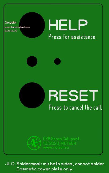

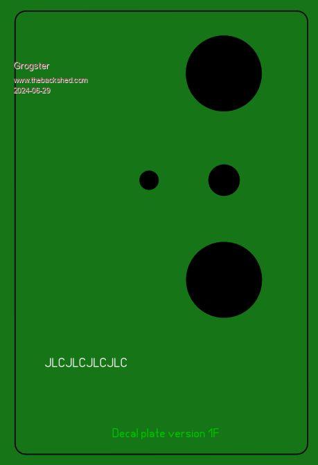

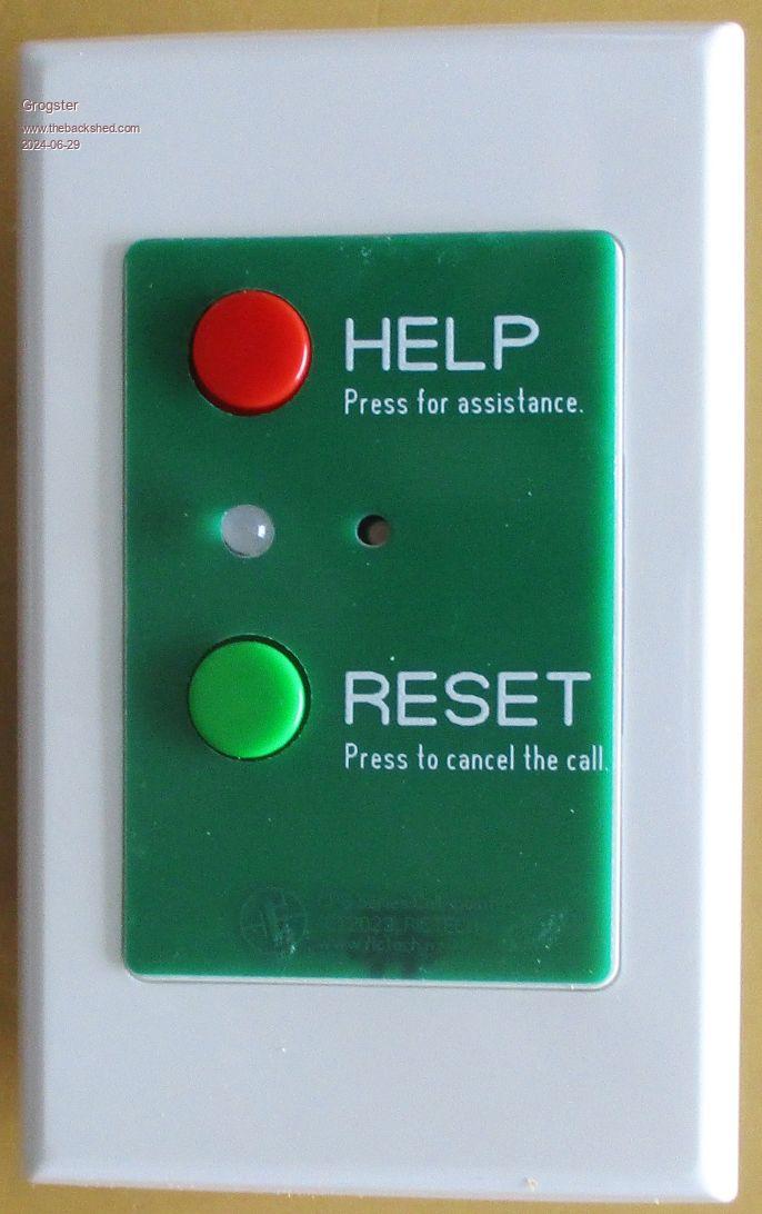

On my latest "Decal plate", I actually have my company logo etc, as copper on the top copper layer, and also something on the bottom layer, both covered with soldermask.
Then, they never ask, as they have all the layers they expect.
This also keeps my company logo etc on the plate, but in a discrete fashion so as not to stick out like a sore thumb.
I get these made in 0.6mm board, so they are nice and thin, and I simply glue them to the top of the(already drilled) wall-plate using a thin smear of silicone sealer.  I use the silicone sealer, as it allows you to "Slide" the decal plate around on the top of the wall-plate, to get it centered correctly.  Once the silicone cures overnight, they are stuck firm, but still reasonably easy to pop off if you ever need to.
Posts: 9036
Posted: 06:49am 29 Jun 2024
Those look good. :)  Doing your logo like that is very neat.
