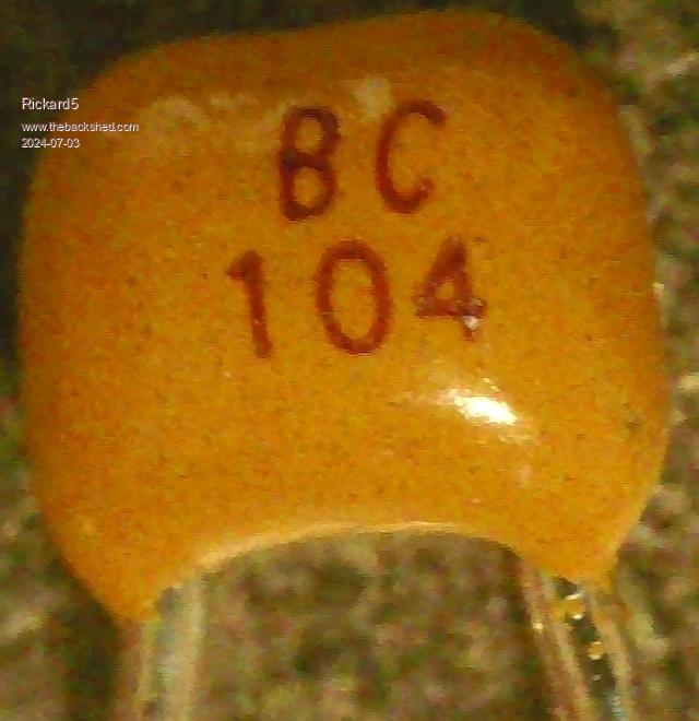

I have been having a problem with all 3 Picomite VGA design #1 SD Cards, and tried changing the SD card socket 2 times and I'm out of Sockets , I've even tried A bunch of SD Card and Micro SD cards, and swapping picos. so the last link in the chain is the 100nF Ceramic or MKT Capacitor. I'm trying to order the 100nf cap but I can Find them on Mouser, Digi-Key or Newark, My such Fu is Week could anyone help me find it on one of those sites
here is the Caps I used,  I might have mis-labeled the bag they were in, I can't read these

  Quote  here is the Caps I used,  ... I can't read these
104 = 10 x 10^4 pF = 100nF.
Same system as resistor colour codes without the colours.

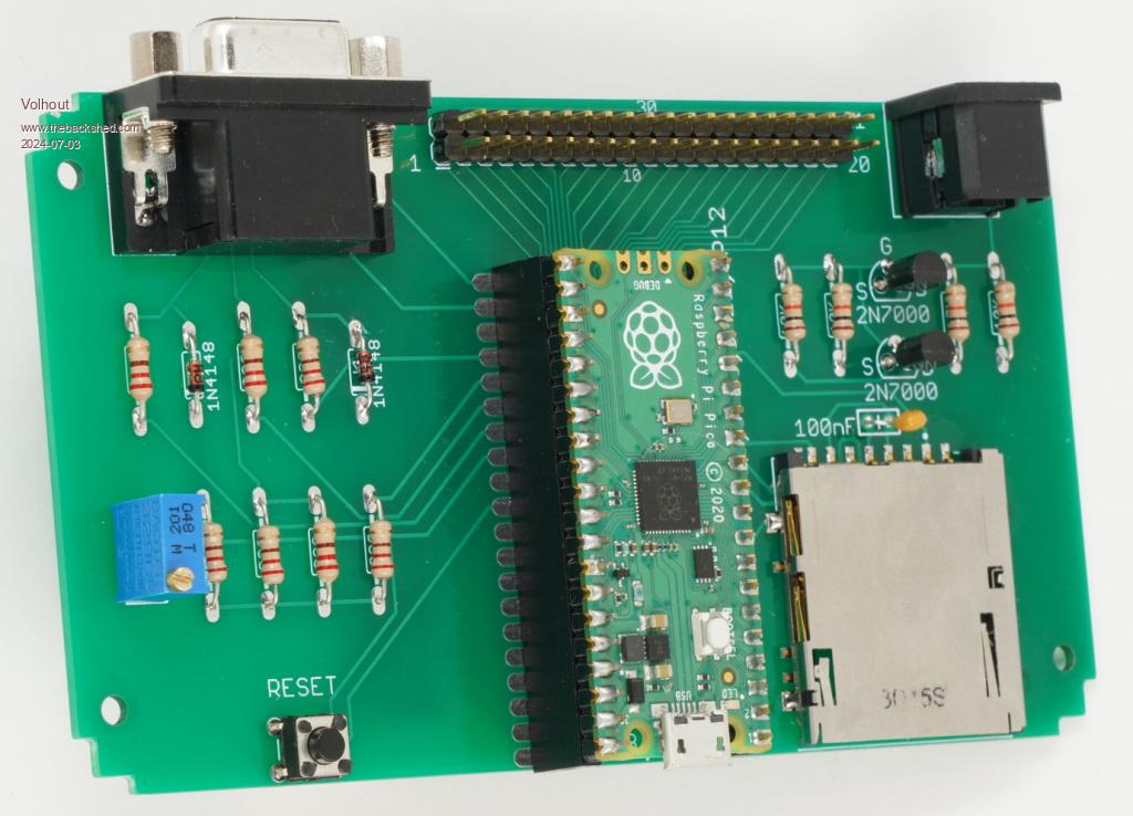

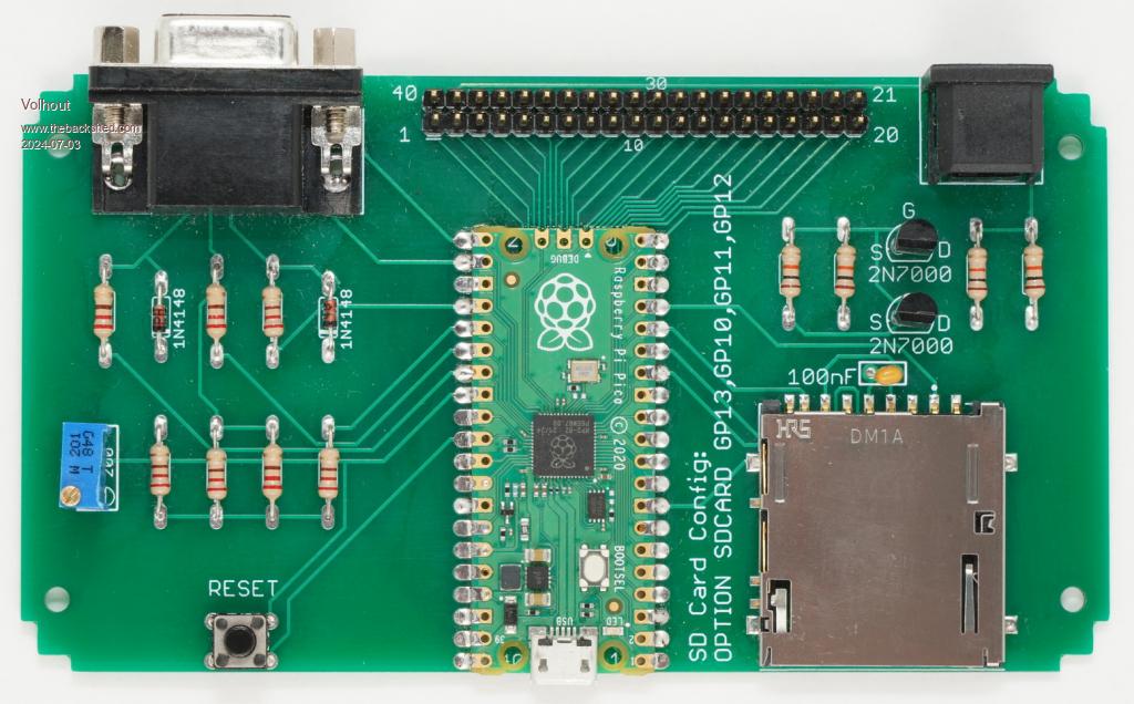

Rickard,
Then you can only suspect the soldering of the Pico itself.
Did you surface mount the pico as below
Or did you use a header and pins (as below)
Posts: 2807

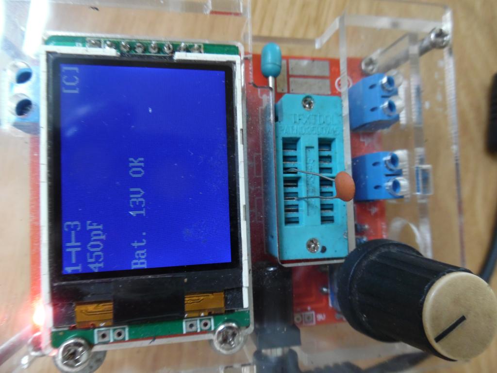

component testers are £5. very useful. got ocillator, pwm, cap esr, inductance, frequency, transistor, resistance

  stanleyella said  component testers are £5. very useful. got ocillator, pwm, cap esr, inductance, frequency, transistor, resistance
Yeah I been Needing to get ahold of one of them :) but where can I find one for 5 bucks :)
