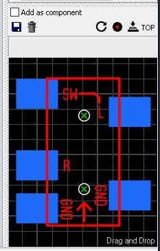

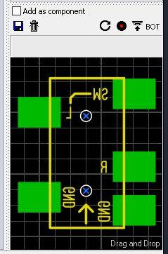

I do have a problem at the moment though. Sometimes when I save a Macro it saves it mirrored horizontally on the back of the board. I must be doing something stupid, or is it Windows?
Posts: 10009

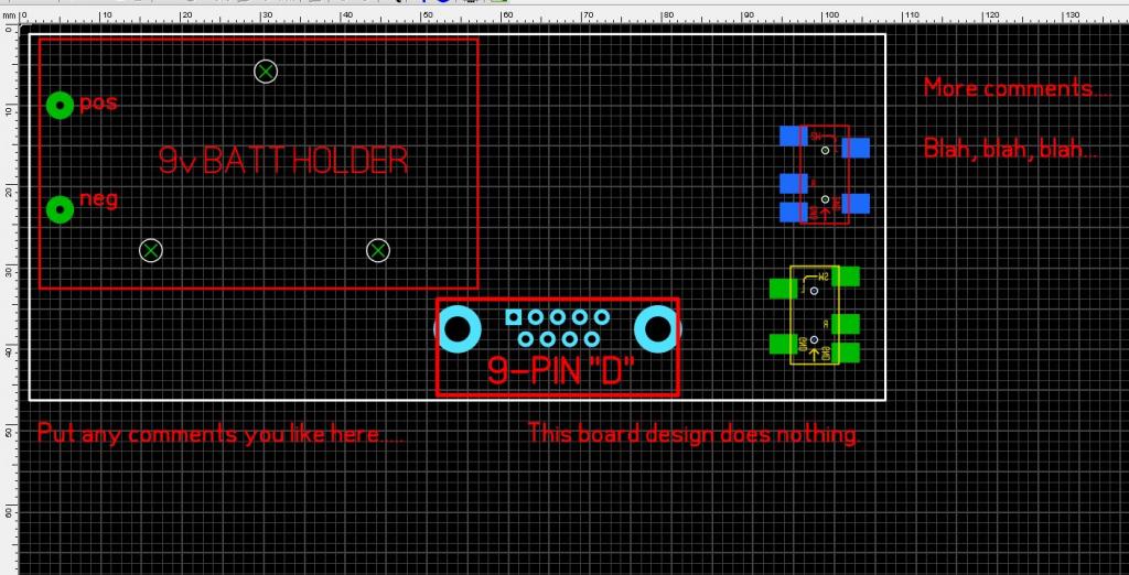

Posted: 02:24am 18 Jul 2024
@ Mick - use the "TOP" button, in the macro preview window.  Perhaps you have clicked that, which would make the macro save as though it needs to be on the bottom side of the board.
For comments, I just make the windows size LARGER then the outline, and put my comments on that.  They never end up on the board in any way(being outside the board outline), and can even serve to give instructions to the PCB house.
I'm with you on the DXF support, or lack thereof.
I wish they would add that.

Posted: 03:52am 18 Jul 2024
"This board design does nothing"
Hey, I've had that same problem

Posted: 08:01am 18 Jul 2024
Thanks Grogster, I'll check that out. :)
Yep, comments are fine outside the outline, they simply crop the board there. Everything inside the outline goes through the DRC and goes on the gerbers though. That means that any comments there have to be on a silkscreen or the outline layer and you have to delete them (not just switch them off) when you get the board made. You can't leave comments there for next time you want to look at the board.

Posted: 08:35am 18 Jul 2024
A possible work-around, create a fake component whose name is the comment.
Eg the "9V-Bat Holder" outline on your Does Nothing board could contain a reasonable amount of text.
