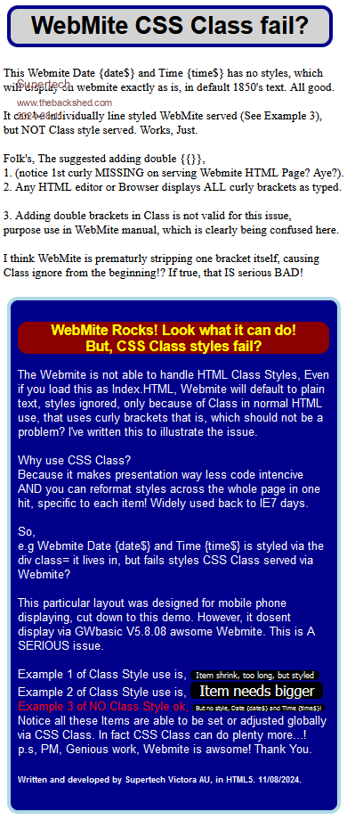

I cant find anywhere to what level HTML coding is supported by said device?
is this a secret? Nothing in Geoff Manual FW 5.08 R3 can I find it.
When writing a web page, it seems if I use certain html commands like 'class' to refer to formatted text, suddenly any text formatting gets defaulted to a basic page of text, all of any , just replaced as raw text?
In testing my written index.HTML on any browser or editor, with the simple things on the page, everything is 100%
So, before writing a simple but nice layout, with some internal CSS (of couse embedded in the HTML file), can Pico W actually support it? I'm running FW 5.08 via Geoff site on Pico W. Ive had good progress, live web page some time now, with inline formatting no problem.
Of course I don't expect to serve HTML5!, but what HTML commands does it do? based on what HTML?
Has anyone tested or know?

<<--FAILS-->>
(note:I learnt professional HTML coding with pro editor. A lot of HTML samples I see on this forum are incredible shambles, not learnt, with eminence format errors, scary)
       <style>
   .myhitxt {
   font-family: Tahoma;
   text-align: center;
   color: darkgrey;
   background-color: black;
   border-radius: 10pt;
</style>
The Webmite Date {date$} and Time is {time$}<br><br>
   The BITBANG DT11 on GP13 is,<br>
   <span style="font-size: 120%">  {mytemp}°C at {myhumid}% Humidity, </span> <br>
   <span class="myhitxt" style="font-size: 100%">  {mytime$}   </span>

The HTML, CSS and JavaScript are parsed and interpreted by the web browser, not by the server device. You can use any HTML version you want, or even send other formats or binary to the web browser, you only need to respect the standards supported by the browser.
Your problem is probably caused by an unescaped character in your source code, such as {, that is used on the template language as a place holder for commands (eg. {date$})
You Will need to escape it in your CSS
.my-class {{
  color: orange;

Unfortunately my post is part misleading, but topic is serious accurate as I was blaming HTML standards while not properly understanding how WebMite server's the HTML its meant to be compatible with.

1. I decided to write a demo HTML which shows for itself what is going on. Self explanatory. Just write in the code!
2. PM, use this demo to fix issue please as it is seemingly 'a translation issue' only you can understand at hardware firmware level. Also this problem will affect ALL WebMite uses, even Geoff demos and manual, specifically HTML compatibility going forward. I'm an ex programmer of many years, so I know, but not as Genius as what you've pulled off here.  Quote of David Letterman, "There is no 'Off' position on the Genius switch." Absolutely!
3. I put considerable time to write it for me to help you sort it and teach other members semi Proper HTML5 as I see a lot of horrendous HTML in this forum, no offense meant dear member's!
For those who are proper HTML proficient, It speaks for itself, please load and read notes embedded in it.
Anyone can  and try the demo here index DBA 110824 for Webmite TBS.zip by
A. Loading into any Browser as is,
and comparing it with,
first, rename this HTML to default index.HTML, then
B. Loading into WebMite itself and browsing its served page, even via a mobile phone it is designed to display on, comparing results. For those that do this, you'll see my shock...
I put an exact snapshot, to show how it 'should look' on any proper browser, and have written it in latest HTML5.
Note to those who say "WebMite is not capable of this very code display layout". Very wrong. In fact it is actually running on my project now, and at warp speed exactly same code layout, with lot more detail, but I had to strip all Class data out! Kind of defeats purpose sadly. Look forward to it being fixed.

Webmite uses  curly brackets as the syntax element to specify value substitution. If you want a { to be transmitted to the browser you must replace duplicate the {
So in the in the example above
     <style>
  .myhitxt {
  text-align: center;
  color: darkgrey;
</style>
the line should be
  .myhitxt {{
Note also CSS files etc. do not need to be embedded. Just make sure the basic program has code to respond to the browsers request for the css file

One possible problem I see in your HTML is it is not ASCII. I haven't tried your code yet but I worry about characters greater than chr$(127).
The other problem is with the {. MMBasic will scan the file before sending it to substitute variables contained within {}
If you add a second { to your styles MMBasic will change it to a single { and leave the closing } as is. There is no need to double up on the closing }
I might have time tomorrow to test your HTML but not tonight.
