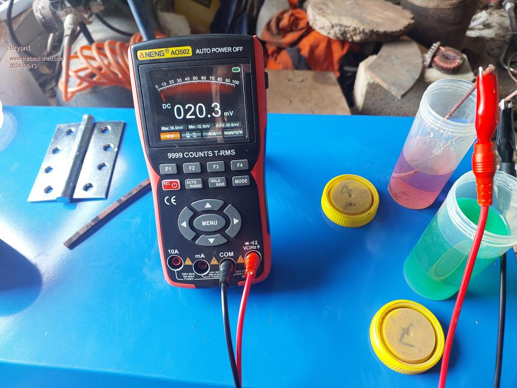

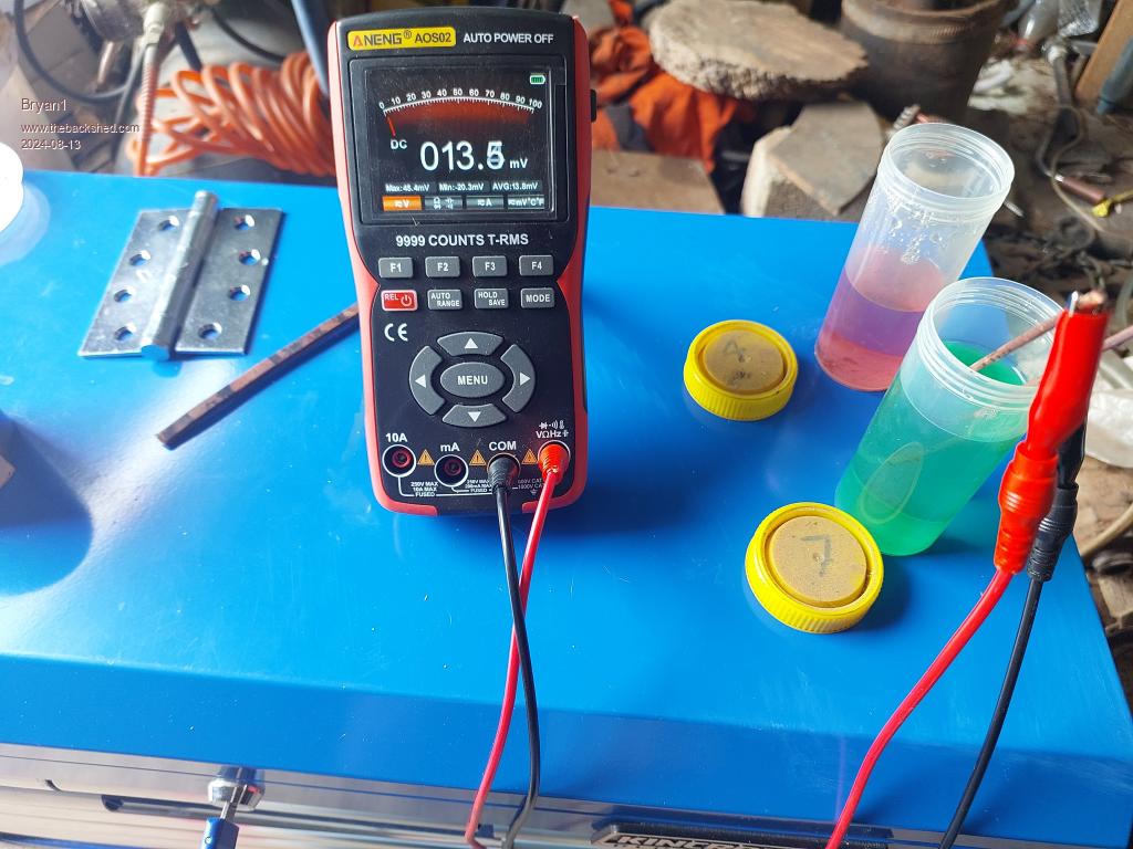

So on reading some of the probes are coated in silver chloride where one probe is in a known PH solution while the other probe is exposed to the liquid.
Now just had a look and guess what I found in my gear, some silver chloride powder in my Dad's gear called Horosilv
So may just have to coat some copper wire and see if I do get a differential reading between the probes and found I did need to have both probes in the same solution.
Ok coated some 2.8mm wire and put the probes in some PH4 buffer
Then some PH7 buffer
Now it did take a minute or so for the voltage to stabilize so the first rough trial is getting there.
Cheers Bryan

  phil99 said  What you are plating that electrode with is pure silver. The silver that is coming out of the solution is being replaced by copper being eaten from the other electrode. The solution will now be a mix of silver chloride and copper chloride, which may turn the solution blue or green as the amount of copper rises.
Yep the solution did go from green to blue so decided to clean up the probes and have another go with the 4 and 7PH buffers and got a total different reading where PH 4 was stable around 4mV and the 7PH was -10MV now looking at the mV range of a PH probe this is way off.
So next trial will be rubbing on this horosilv with a damp rag to some thin brass plate as thats how it reads to apply the stuff. Then cut the probes to size and see how it goes.
As I do have that silver chloride here may aswell use it and see if I can get close to what the spec's say and it is all a bit of fun.
Anyway a  good read about mV ranges of PH probes and the slope.

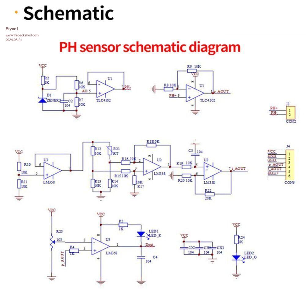

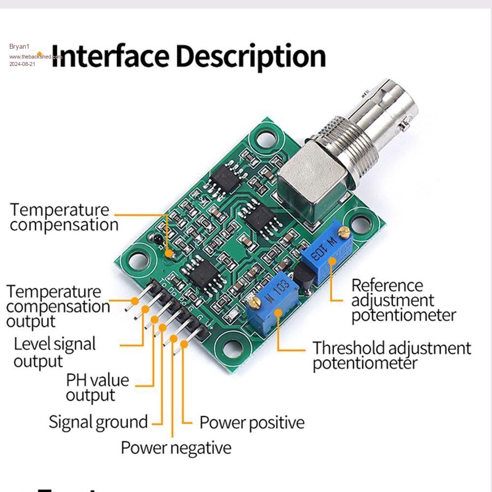

Posted: 11:29pm 20 Aug 2024
G'Day Guy's,
           Well finally got some info on this PH sensor and here is the schematic for the sensor board.
Now here another pic showing the connection setup.
Just checked the tracking and it's still a week away but now got some info to work with.
Regards Bryan

Posted: 02:43am 21 Aug 2024
There are standard ic's for this task eg
this  which is worth a read
