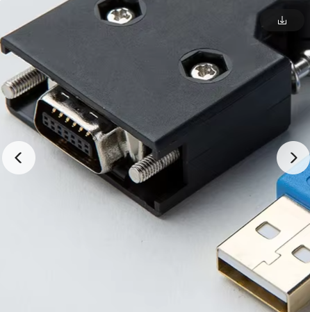

Just hit my pet-peeve roadblock with one of these Yaskawa drives. I need to disable the internal control-loops because the PicoMite will be handling the PID, etc.
There is a small control panel on the front of the drive with buttons and seven-segment display but the display disappears after a couple of seconds. Ah-ha, I can connect serially which is actually easier and I have the programming software. It requires a USB to serial cable of which I have many....BUT...
Naturally....I need a special cable
So sick of these games that these big manufacturers play...OK they charge stupid money for the cable but for the end-user? Yeah it takes a week to get one.
"Sorry employees, we need to shut the doors for a week and we might lose the contract"
At least I can work on the other axis
