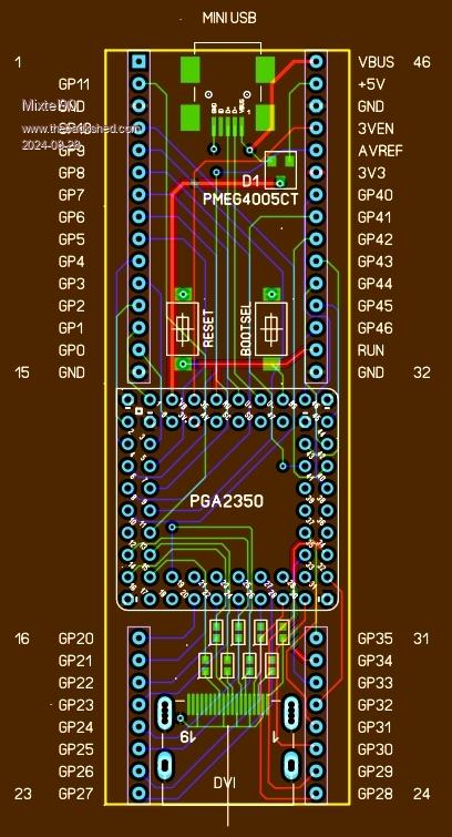

No, it's not quite ready yet. I have a couple of problems at the moment but it's  -so- close, I think!
On the other hand you could just get one of Pimorini's Pico 2 Plus boards. It's not that far different. Mine just has class though....   :)
There are probably still stupid mistakes lurking. Some CVI pins aren't connected either. I'd like a heartbeat LED (which might make GP25 a mess unless I leave it).
It's 0.8" wide, so a bit bigger than a Pico. No point in squashing it when the board width is decided by the PGA.
Mini USB? Yes. I have a load of them, they are cheap, easy to get and pretty rugged. They are also much easier to solder than USB-C or micro USB.

Maybe (not certain) if you rotate the PGA 45degree you could compress the vertical rows of pins a bit and make the height of the PCB a little shorter.
Mick (the big one)
Posts: 9383
Posted: 06:51am 28 Aug 2024
I tried that but I was unhappy with the width. Even if you keep the same pin spacing the PGA is obscuring quite an area of the breadboard. Eventually I decided that it was better to sacrifice length.

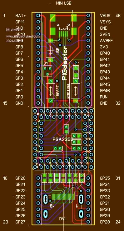

Fixed it, I think.
New slimline version is 1" wide, pin centres are still 0.8".
Resistors increased to 0805 as this is the smallest size I can solder with any certainty!
Heartbeat LED and resistor added directly to GP25 so if you use it as an input you'll light the LED.
Power supply rearranged to make it more like the Pico but with a BAT+ input that feeds VSYS via a diode.
USR button added on GP29
RUN button
RUN & USR buttons have capacitors. USR has a series resistor too.
Given it a nice name 'cos it was a pig fitting it all in.
Sorry, no Debug port (if anyone uses it).
Can't find a use for GP36, 37 & 38. :)

Got a Debug port on it now. :) A 1mm NSH though, not much room for anything else. I think this will probably be the end of the project.
The furthest holes on my breadboards are 1.1" apart and my headers are 0.8" apart. That gives a single row of holes on one side and two on the other for connecting bits. Ideally I'd have liked 0.7" apart but the DVI connector won't fit at that.
The PGA is going to overhang anyway as its outer pins are 1" apart and, unless the board is shaped, the holes are wasted anyway as when you plug it into the breadboard as this is at low level and you can't get to them.
The only way to get an SD card holder on is to either make the board even longer or change to a fully SMD USB connector and put it underneath. There may be problems getting that to work without the plug fouling the card. anyway, the only spare GPIO pins on the PGA would have to fight through a serious maze! I don't think there are enough routes left without seriously shrinking the track widths (I'm at 0.18mm now). I can't have more than four layers in this software.
Whether this is worth it when Pimorini's Pico 2 Plus board already has everything for only £3 more than the PGA2350 I don't know (except that I think this might have more IO pins). It's an interesting exercise though.

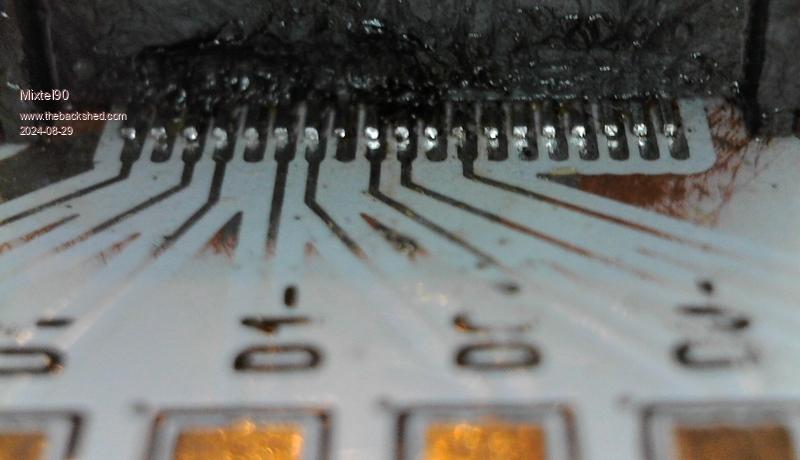

Yes, it's possible to solder DVI connectors without much in the way of special equipment. You do need some sort of inspection microscope though. Tiny solder bridges can be a real pain.
This was a mess to start off with as the solder mask was still on and I had to sand it off before I could start! It is my very first attempt at 0.5mm pad pitch though, so I hope you'll forgive some melted plastic.
Pointed soldering iron at about 350C
fine solder
0.5mm solder wick
gel and liquid fluxes (the latter for final cleaning up)
flux cleaner
cotton bud
magnifying glasses
hand-held inspection microscope
multimeter (pointy probes are good for helping to clear solder blobs!)
You need to check for shorts between adjacent pads and to ground and also for continuity to the pins within the connector. If the first two tests are clear then this one is actually quite easy as you don't need to be accurate in finding the pin.

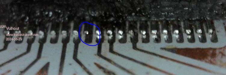

Posts: 6276
Posted: 01:35pm 29 Aug 2024
Mick,
I would check this pin.... It looks the soldering is different.
Posts: 9383
Posted: 01:51pm 29 Aug 2024
Will do. It's a ground anyway. Thanks.  :)
I think it's stuck. I had some solder wick problems and a strand or two stuck at one point and broke off. I think that's seen in the pic as a strange connection. Very difficult to test without a male plug connected to terminals. I really should get one!
Yes, all the ground connections were ok but I found another solder blob between two of the pins that aren't in use. I've managed to clear that.

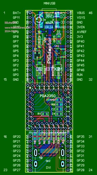

Posts: 9383
Posted: 10:23am 30 Aug 2024
JLCPCB's production cost for these is $7 for 5 unpopulated boards + shipping etc.
When you add in the cost of a PGA2350 it's starting to look expensive compared to the Pimorini Pico Plus 2.
Everything to date. There are minor tweaks done. I'm not intending to do anything else now.
