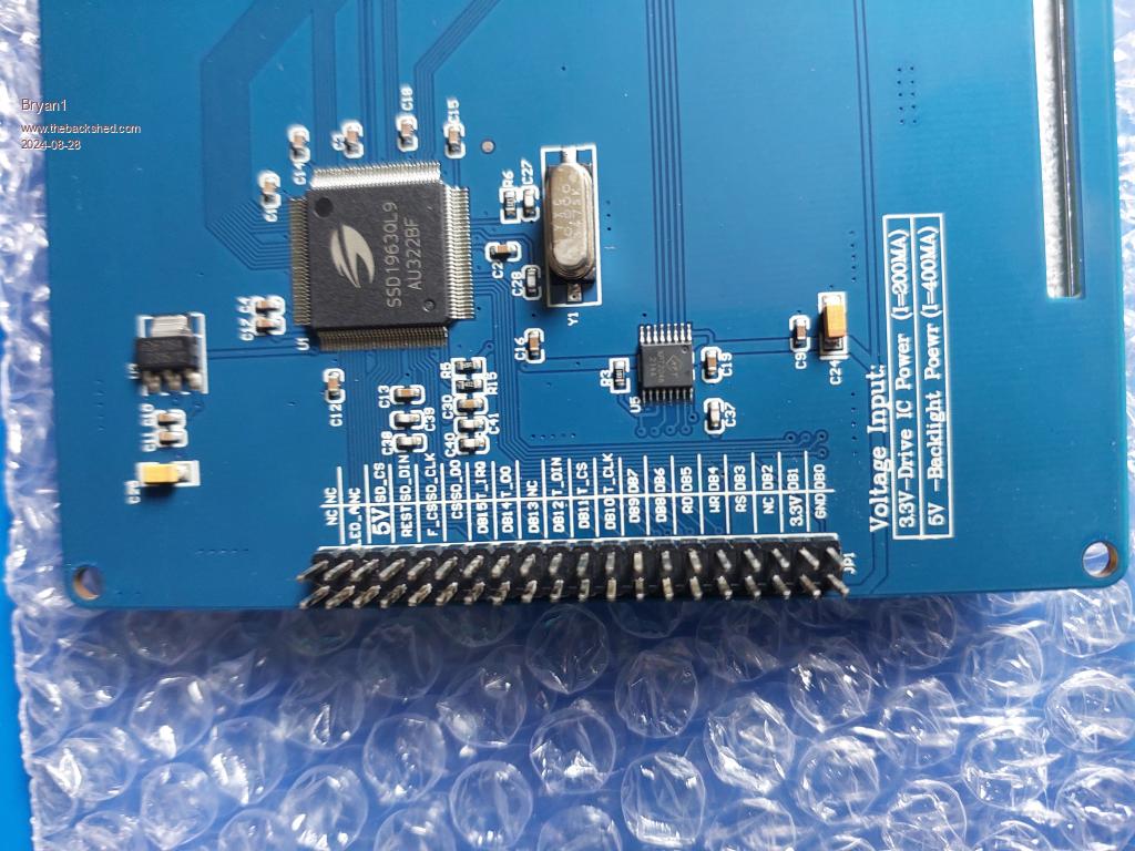

G'day Guy's,
           Well I bought this and it clearly stated SPI or do I have it wrong that these size displays do need a 16 bit connection.
Anyway got 5 standard picos on the way as the zero doesn't have all the pins to run this.
Regards Bryan
disco4now
Joined: 18/12/2014
Posts: 1138
Posted: 04:32am 28 Aug 2024
The SPI would be referring to the touch interface. They can be run with 8 bit parallel, the Picomite manual gives the wiring. The pins for D0-D7 are fixed, but   you can be flexible with RD,WR,RS and Reset pins
F4 H7FotSF4xGT
Posts: 9036
Posted: 06:58am 28 Aug 2024
More AE inaccuracy, I'm afraid. :)
They are a very nice display though, even if you need a lot of GPIO pins. Faster than SPI displays by quite a bit.
