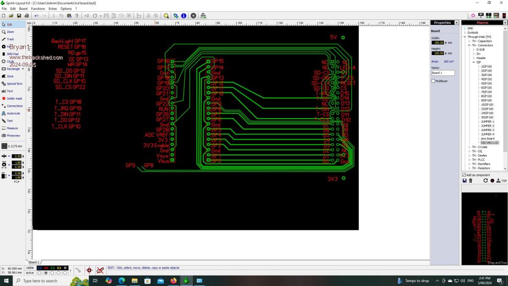

G'Day Guy's,
            Many moons ago I used to use Sprint Layout 4 for all my pcb designs and with the HPGL output I was able to mill the boards on my cnc.
So last night bought Sprint Layout 6   and it hasn't taken long to give me that bug of playing with it
Now as I bought a 7" 8 bit LCD with SPI decided to have ago at making up a board using the pins from the picomite user manual. I did have to make a couple of changes but so far got it done using a single layer.
Still a long way to go now with the changes I had to do with the pins hopefully it won't cause any issues.
Regards Bryan

Well just came up to the shed and found I got the header on the LCD backwards   O'well it's all a relearning curve and I do need to make the pico and lcd header a macro time to start again.
Ok saved the pico board and the LCD header as macros and started from scratch   managed to route every pin to the pico manual with only the 5V and 3V3 power lines needing a jumper. So this can now serve as a template as the pins left will be the same for each one.
As i'm new to winsucks still need to find a decent zip software that won't try and take over the computer then i can upload the sprint file.
Regards Bryan

Did you run it through DRC (design rules check)?
Might be the screen grab but it looks like some of the traces are a bit close together.

No DRC check but every track proved good using the test function in Sprint, honestly all last night and most of today I've been playing with this and I'm happy with the challenge set to route every pin to the manual.
I found this box to be the right size for the 7" lcd.
Now I've been thinking just how to power this and that head torch I scored at work may just fit the bill. 2 off 3.7 volt 2200mAh 18650 batteries in parallel so I do need to get some 3V3 regulators to setup the 3V3 power rail and just one pin to look at the battery voltage and state of charge then it's a case of sticking on a usb cable to charge the batteries.
I am thinking of putting on a sea of holes just so this design can get off to JLCPCB which will be a new learning curve with this software.
Regards Bryan

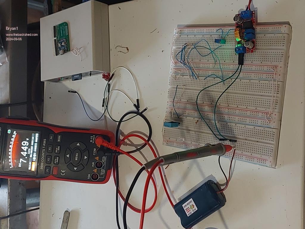

Mick I do have some of these and I got them for my inverter projects. Now my 9 volt to 5 volt breadboard power supply had a flat battery so I just set one of them to 5 volts and it worked a treat.
35 volts max input and they simply use a trim pot to step down the voltage, bought 10 of them so got plenty to play with.

Well in to see the battery man this morning and grabbed a 18650 pack so 2 0ff 3450mAh batteries in series with a PCM protection circuit.
I dialed in one of those DC-DC boards to 9.6 volts and the battery is charging now
Now a green led shone when the DC-DC board was connected and when I turned on the power to my bench power supply a blue led shone. Just checked and the voltage is up 8.1V so it does look like this DC-DC board can be part of this project then to charge just a DC source higher than the battery voltage will be needed to charge the battery.
Regards Bryan
Edit: Well 9.6V was too higher a voltage as when the DC-DC board cut off the voltage dropped to 7.4V. So dropped the voltage to 8.6 volts. Now with the input voltage at 12 volts 680mA is the current draw on the power supply so I do think just hooking up the project to a 5 watt solar panel on a sunny day will charge the battery.
I found this little DC-DC boards are quite handy and one is finally being used to do it's job but if one does need a DC voltage this units just work.
Edited 2024-09-06 13:14 by Bryan1

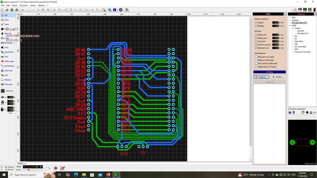

           Well that Altronics package arrived today so I did get on make the cut out for that 7" LCD and it fits like a tee to the box.
Anyway finally got on to that link Mick put up with those switchmode regulators so ordered 10 each of 3V3 and 5 volts ones. Now would it be the best to feed the 3V3 one with the 5V one or just keep them separate.
Also just now got on and started from scratch again and this time got all the connections done to the manual quite easily leaving all the available pins free. Now by using a 10K and 4.7K voltage divider @ 8.4 volts the output is 2.686 and I reckon pin GP8 could be used with this voltage divider to measure the battery voltage.
Also found 7-zip so here is the sprint file for this V3 design I'm working on
lcd V3.zip
Regards Bryan

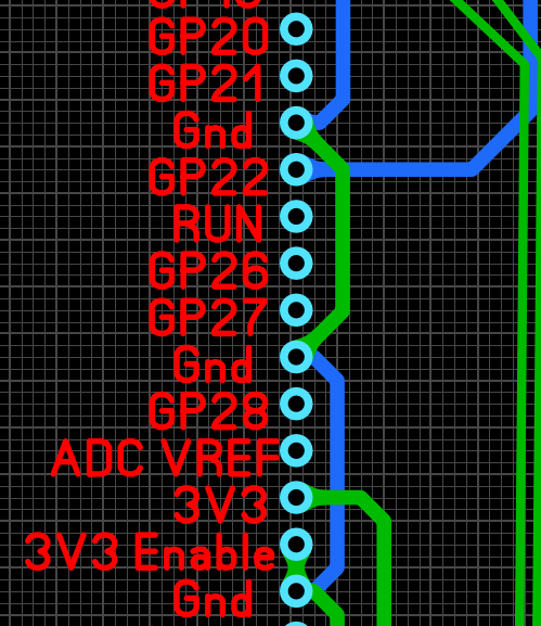

Hey Bryan,
I was almost offended   by the "skinny-ing" of the ground trace so I switched it to the other layer(?):
Bryan1
Joined: 22/02/2006
Posts: 2217
Posted: 09:26am 11 Sep 2024
Duly noted and changed so thanks mate, still learning here and eh it was under an hour to get that far.
