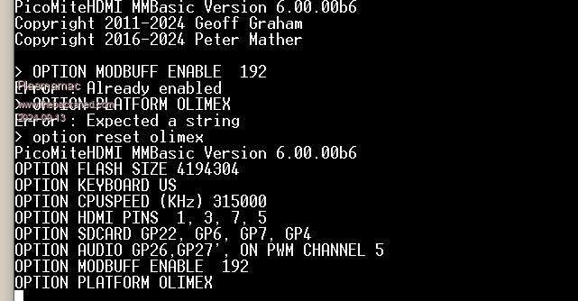

I can’t get it to run 😵‍💫 what do I need todo?

> option list
PicoMiteHDMI MMBasic Version 6.00.00b6
OPTION AUTORUN  ON
OPTION FLASH SIZE 4194304
OPTION KEYBOARD UK
OPTION CPUSPEED (KHz) 315000
OPTION DISPLAY 24, 80
OPTION HDMI PINS  1, 3, 7, 5
OPTION MODBUFF ENABLE  192
OPTION PLATFORM OLIMEX
it's OPTION PLATFORM OLIMEX
> made it work 4 me
Posts: 2807
Posted: 07:05pm 12 Sep 2024
try in terminal OPTION PLATFORM OLIMEX
Posts: 2992
Posted: 07:08pm 12 Sep 2024
Think it may be the following you type (at least I did, and it worked for me):
OPTION RESET OLIMEX

come not back
Plasma
Posts: 6171
Posted: 07:18pm 12 Sep 2024
Hi Plasma,
Re-install the software,
type "OPTION RESET OLIMEX"
OPTION RESET puts all the IO in order (HDMI)
OPTION PLATFORM only gives your Pico a name.
You can always type
OPTION RESET LIST
And then you see what hardware platforms are supported. OLIMEX should be among them.
