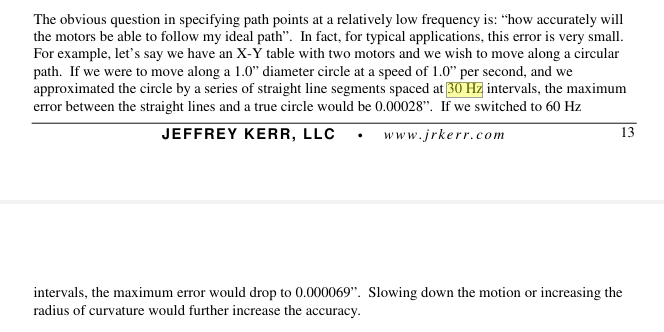

I asked this because I have, historically always used a 1KHz sample time...just because it's common but I have been playing around with 250Hz (settick 4) sample times and experiencing a surprisingly nice response.
There are endless publications (I think I have them all  ) re: the actual PID but sample-rates are rarely covered.
I have an app-note, somewhere, about positioning to a few nano-metres
This was a piezo-electric motor on air-bearings. Galil-Motion have the capability of reaching 16KHz sample-rates but they found that there was nothing to be gained beyond 4KHz.
Our PicoMite can handle 1KHz without breaking a sweat.

That is irrelevant. Mechanical elements have a limited bandwith. 1KHz is the magic 10 X multiplier for a machine with a bandwidth of 100Hz. That would have to be a tiny machine with hardly any mass/inertia.

Machine moves are a different thing entirely:
In my case, machine-moves are incremented @500Hz.
