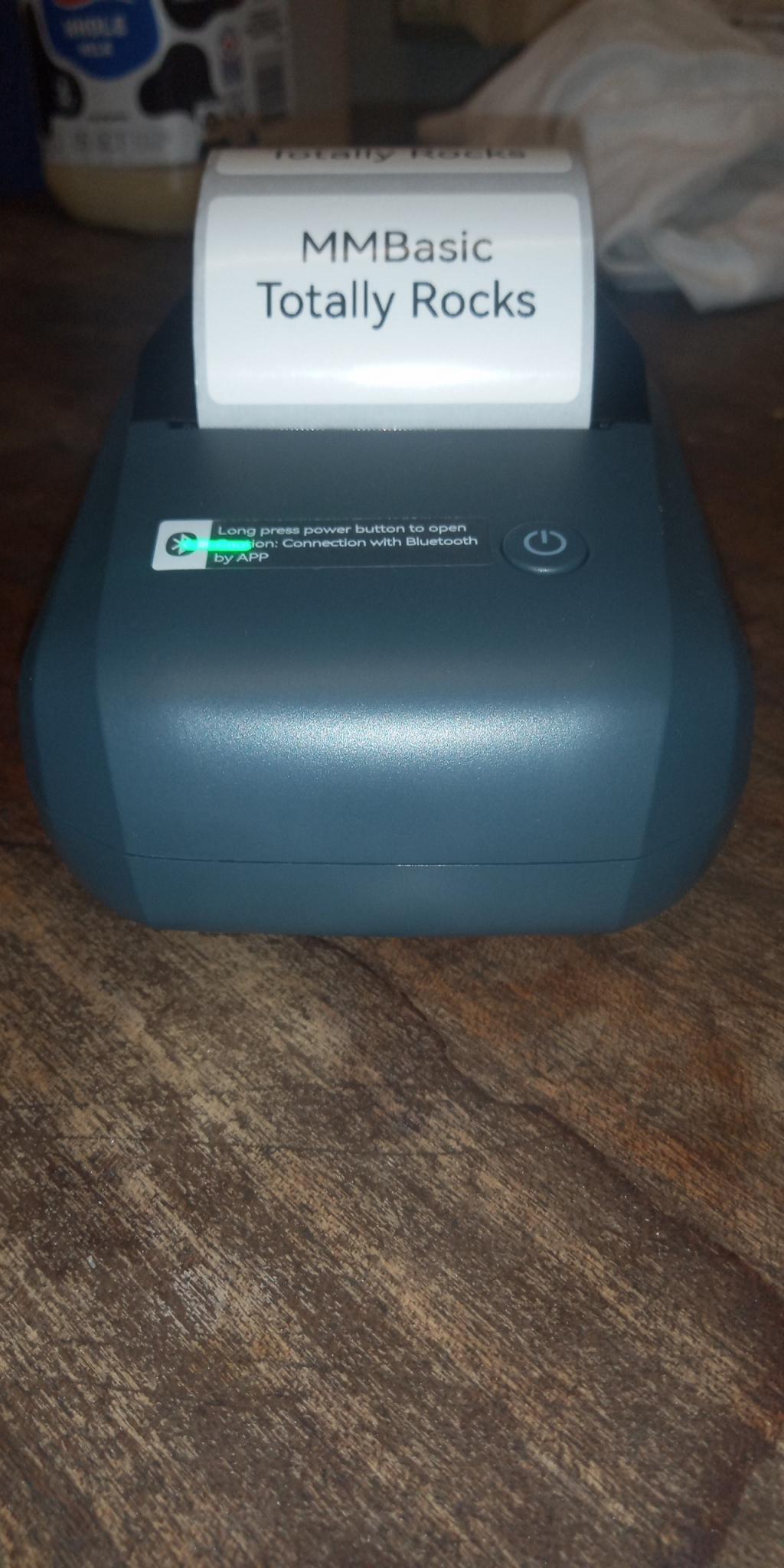

I ordered a Niimbot B1 (yes double I) and it just arrived.
Very cool. I need to ID lots of components in the control panel and this is just the "ticket"

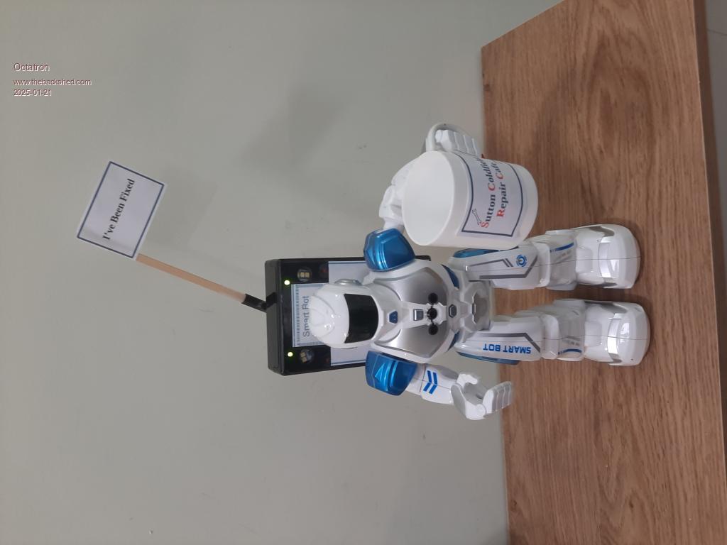

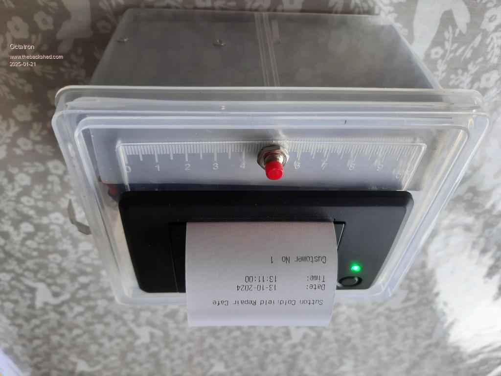

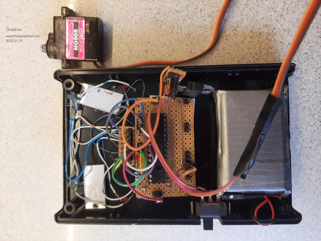

I thought I would give an update on my mini printer project. Which was slightly delayed by a flag waving backpack for a robot. I used PIC32MX150 that I had to hand built up on some veroboard and installed not very neatly in the backpack. A servo motor was used to wave the flag and there were also some LEDs to be flashed.

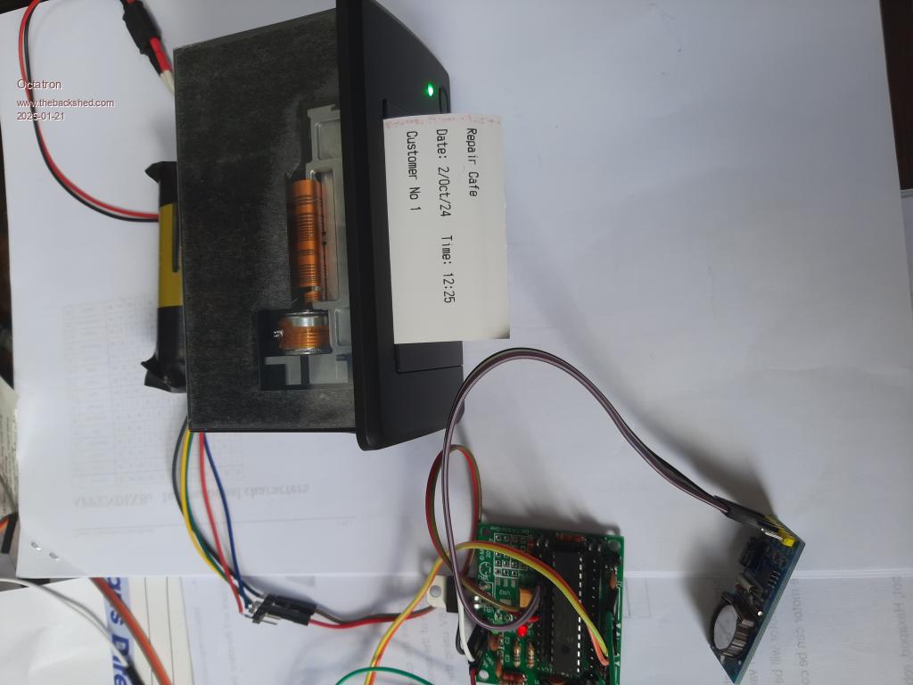

Anyway flag waving robot completed mini printer to focus on. The first thing I discovered was that my lab power supply at 0.5A max wasn't man enough to power the printer evidenced by not fully printing out the test print, LiPo batteries came to the rescue. I used again a PIC32MX150 on Mick's uMite PCB along with a RTC a few lines of code and the project was complete. Let me know if anyone needs more detail.
