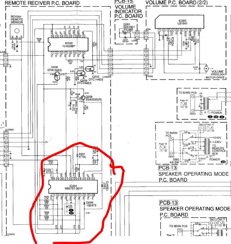

To go with the NEC protocol here is Philips RC-5
Sub IR_RC5_Rx and Sub IR_RC5_Tx are the useful bits in this program.
The rest just reads and decodes the Manchester protocol, sending the result to the console.
Then transmits the IR code 3 seconds later to the device so you can verify that it is correct. The codes it produces match the published ones so it should be ok.
The older version of RC-5 sends a Start pulse, a Control bit to distinguish a double press from auto-repeat, a 5 bit device code and a 6 bit key code.
As that only gives 64 key codes the current version has a Field bit between the Start and Control bits to provide another 64 key codes.
Field = 1 for keys 0 to 63
Field = 0 for keys 64 to 127
Control alternates between 0 and 1 on each key press.
Sub IR_RC5_Tx should work with all the above but the devices I have (Philips audio system & Schaub Lorenz TV) both use Start = 1 & Field = 1 so the others are untested.
For old devices that don't use the Field bit set the Start bit to 0 and the Field bit to 1. The Field bit becomes the Start bit.
Usage: IR_RC5_Tx start, field, control, device, key
Eg: IR_RC5_Tx 1,0,17,63 turns on the sterio and IR_RC5_Tx 1,1,17,12 turns it off.
If you want to modify the subs for your own projects there are plenty of comments and diagnostic prints to help.

Getting the BitStream to work properly with Manchester half-bits realy taxed my geriatric brain. Senility is advancing.
Edit 29/09/2024
The code above has been edited. A closer inspection of the output for the old version of RC-5 was not quite right. Should now be ok, but still can't test on an actual device.
However sending from one Pico to another does work and scope pics of the data appear to match the specification.
Also added automatic detection of old RC-5 to IR_RC5_Rx Sub.
Output when receiving.

At the moment I do some reading about the NEC protocol. This is very good information at a level that I can understand.
The reason for this is that I bought a beautiful vintage amplifier, HK6350R, without a remote. The device had some strange problems, the volume runs high or low at random or dropped random in standby mode. The problem was the M50761 processor IC201. After I removed this chip everything worked normal albeit without remote control.
Now I'm trying to add "something" to this amplifier to get the simple remote function for volume and standby back. I can drop in an Pico or Arduino but I also have some PIC-controllers lying around that I can use, such as the PIC10F200. A simple little controller.

Marcel27
Joined: 13/08/2024
Posts: 104
Posted: 06:11pm 11 Oct 2024
@EDNEDN. If the idea I have in mind works, I can program the code from my HK AVR145 remote for volume + and - and Pon, Standby in the pico and use my HK AVR145 remote for the HK6350R. The controller chip M50761 I removed from the HK6350R controlled only volume and standby/pon and did no security checks. I can even use an Onkyo amplifier remote. The only thing I have to do is to integrate the pico in the HK6350R with all the klimbim. The HK AVR145 or HK6350R never run simultaneously and when they do I use an unused device code e.g. TAPE device button.
Thanks anyway for the information   , I'll check it out.
