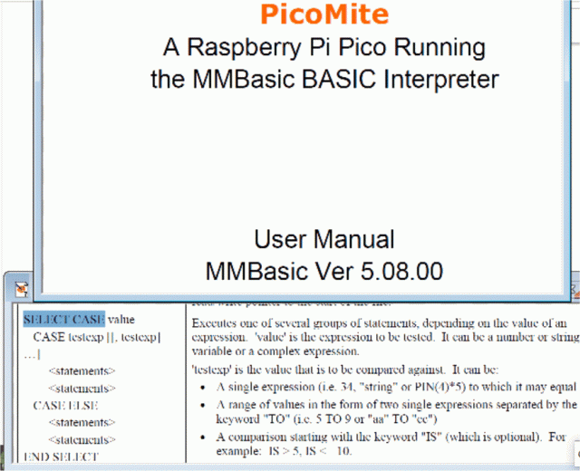

Hi,
Another standard function missing is SELECT / CASE.
Will be nice also.
Best regards
Georges

PicoMiteVGA User Manual Page 97
SELECT CASE value
CASE testexp [[, testexp] …]
<statements>
<statements>
CASE ELSE
<statements>
<statements>
END SELECT
Executes one of several groups of statements, depending on the value of an
expression. 'value' is the expression to be tested. It can be a number or
string variable or a complex expression.
'testexp' is the value that is to be compared against. It can be:
 A single expression (i.e. 34, "string" or PIN(4)*5) to which it may
equal
 A range of values in the form of two single expressions separated by
the keyword "TO" (i.e. 5 TO 9 or "aa" TO "cc")
 A comparison starting with the keyword "IS" (which is optional). For
example: IS > 5, IS <= 10.
When a number of test expressions (separated by commas) are used the
CASE statement will be true if any one of these tests evaluates to true.
If 'value' cannot be matched with a 'testexp' it will be automatically matched
to the CASE ELSE. If CASE ELSE is not present the program will not
execute any <statements> and continue with the code following the END
SELECT. When a match is made the <statements> following the CASE
statement will be executed until END SELECT or another CASE is
encountered when the program will then continue with the code following
the END SELECT.
An unlimited number of CASE statements can be used but there must be
only one CASE ELSE and that should be the last before the END SELECT.
Example:
SELECT CASE nbr%
CASE 4, 9, 22, 33 TO 88
statements
CASE IS < 4, IS > 88, 5 TO 8
statements
CASE ELSE
statements
END SELECT
Each SELECT CASE must have one and one only matching END SELECT
statement. Any number of SELECT…CASE statements can be nested
inside the CASE statements of other SELECT…CASE statements
what exactly are you missing?
'no comment

Hi,
I see nothing in the PICOMITE 5.08 Manual but it work.
Best regards
Tanks
Georges
Posts: 3885
Posted: 12:19pm 24 Sep 2024
  georgestheking said  I see nothing in the PICOMITE 5.08 Manual but it work.
