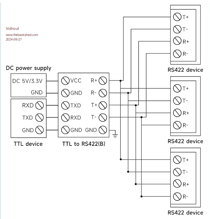

Quite like the look (and price) of this
Obviously auto-enabling and I like the isolation and selectable terminating resistor.

Looks nice, but...
1/ It can be powered by 3.3V. I wonder how good that is for an isolated switcher.
2/ some of the datasheet is incorrect. This can not be done with RS422, or they violate the output specification, in which case I would not use the device. Outputs cannot parallel. In RS485 you can since they are disabled when not driven, but RS422 is always ON.

That's my point Harm. Lots of newer devices sense the data and auto-enable/disable.
Even their 485 devices only require RX, TX, GND on the TTL side.
