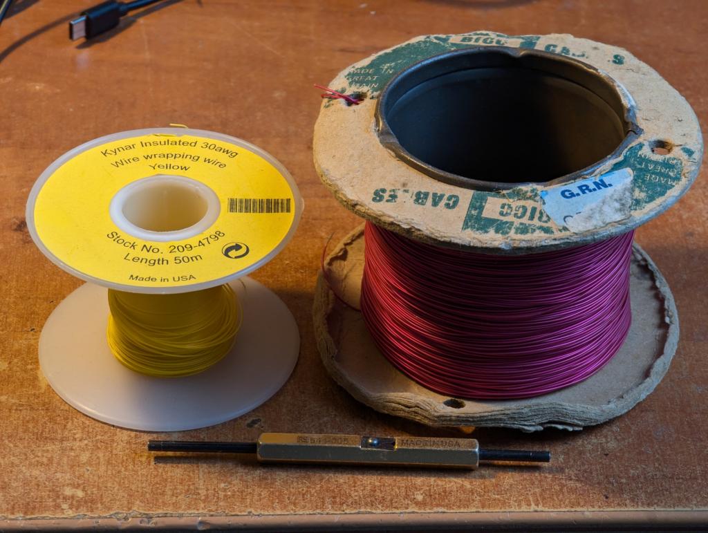

Not recently but........
The red kynar is at least 45 years old and still as good as new

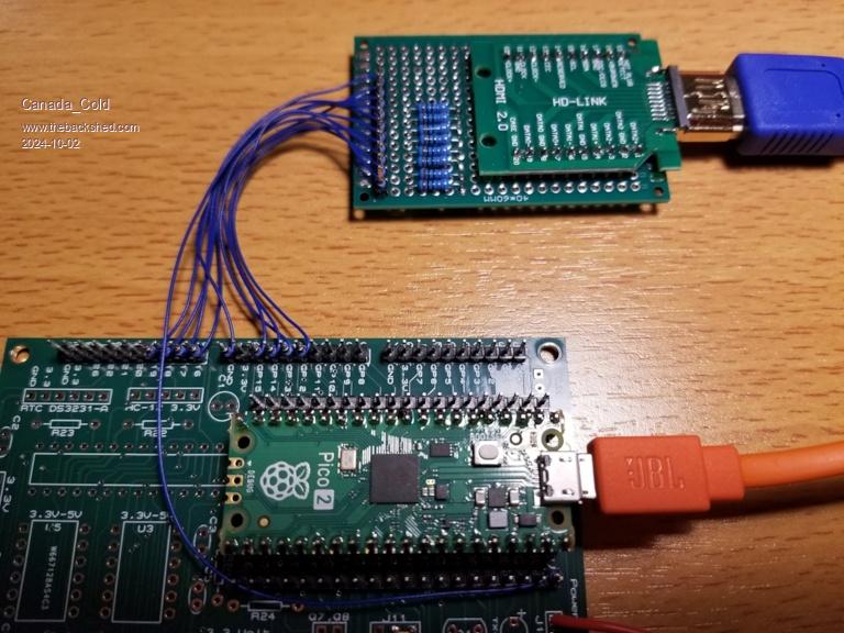

Yes, I still do a lot of WW for prototo typing.

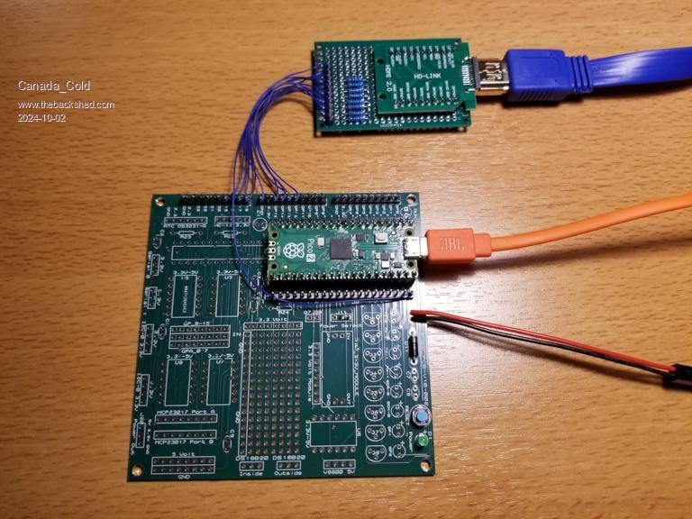

Here is the HDMI interface I pulled together.

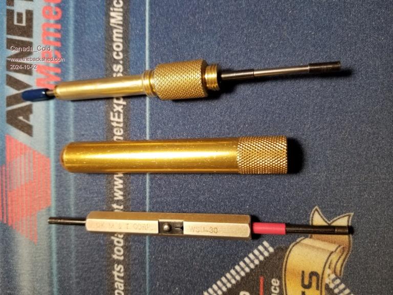

The tools I use for small projects.  The tool at the top of the picture is a an original OK Tool hand wrapper I still use most often.

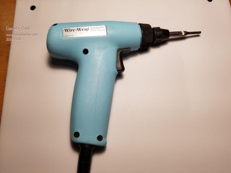

WW gun for larger projects

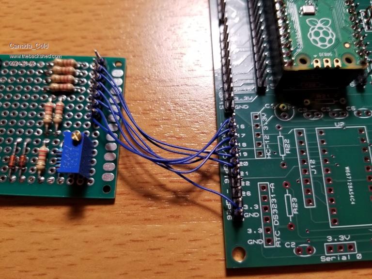

The VGA board

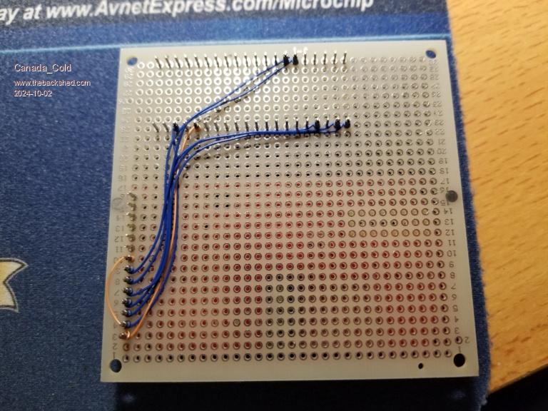

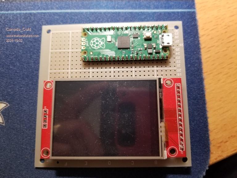

And a very old board when I started with the Picomite and an LCD.
Wire wrap might require more time to build, however it makes good gas tight connections and is very easy to modify or pull apart.

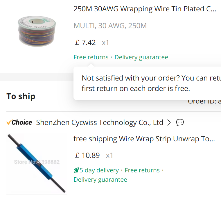

I love it   Duponts get messy.
Just ordered from AE

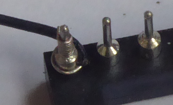

Just for giggles, tested the new toy on a thin, round, IC socket pin.
It certainly doesn't want to pull off and there aren't any corners to bite into.
Does a perfect job, every time, no fiddle-farting at all. This is a great solution for some of the stuff I do.
No-wonder it wasn't the typical AE price because the tool is an actual OK Industries device, in original packaging. Even liking the seemingly crude wire-stripper which I expected to hate (I'm a Knipex fool  )
