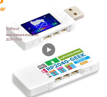

MMBasic runs on it, even has OPTION RESET RP2040-GEEK
@Phenix: thanks, I though Annex was stopped. But apprently it is alive again.
Edited 2024-10-09 00:37 by Volhout

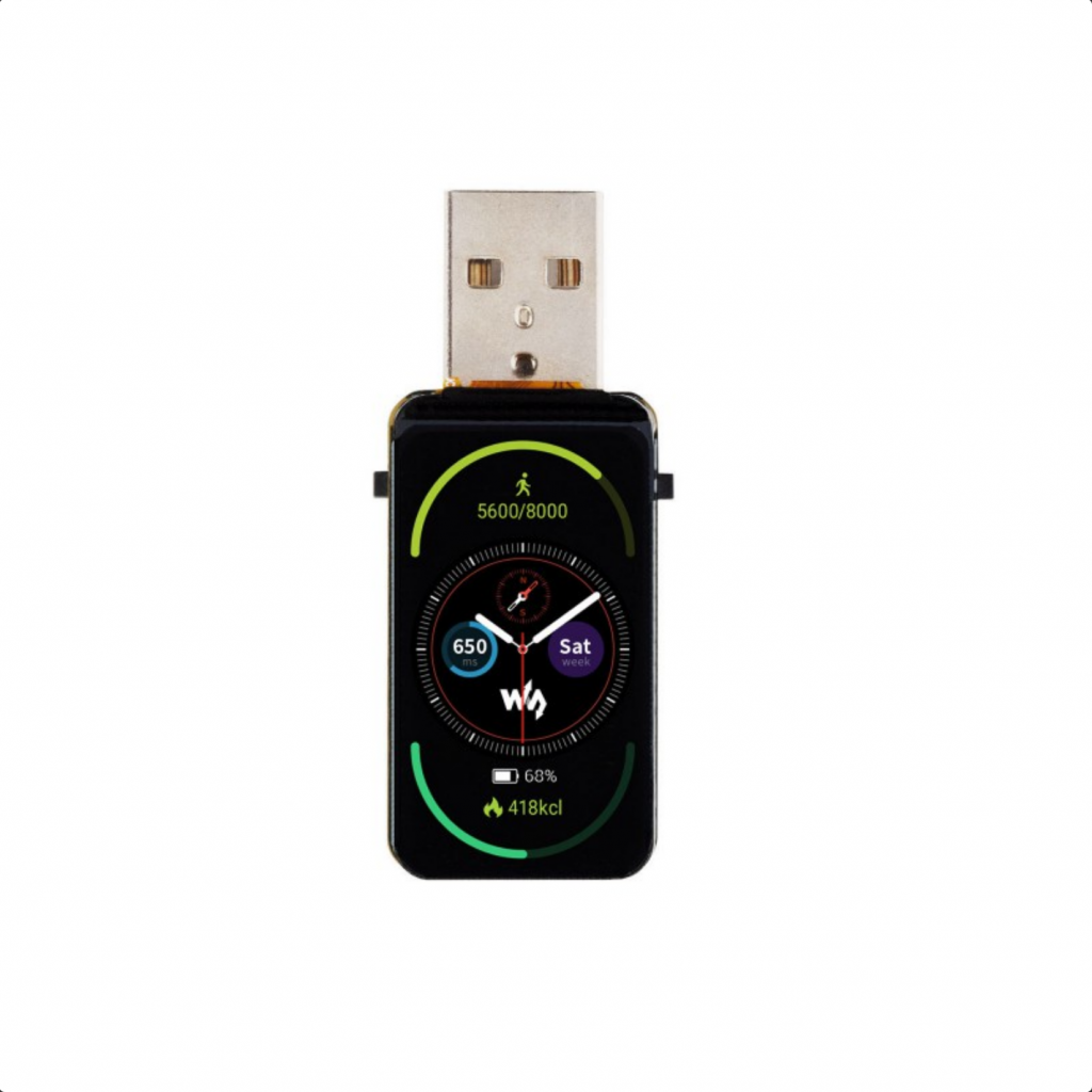

Or even, <Deity> help us, this!  :)
