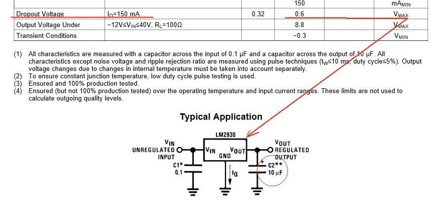

oh3gdo
Joined: 18/11/2021
Location: Finland
Posts: 47
Posted: 11:23am 09 Oct 2024
asknik2022
You can use also low dropout regulatrors lik LM2930
It has only 0.6V minimim dropout, but remenber to put 10 uF capaitor to outputput.
I remeber when I did't do so, i statrs to oscailate!
It is similar to LM7805
