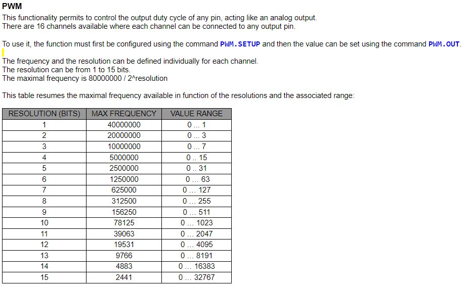

What precludes us from having a PWM like this?
It has been explained before but it went straight over my head

  Mixtel90 said  The PWM system uses hardware modules on the RP chip. It's not all handled in firmware.
Ah, I should have been more specific.
In the above table, it shows the option of 19.531KHz with 12bits resolution. This is great for driving H-Bridge + motor. But we only have ~10bits, no matter the frequency, right?

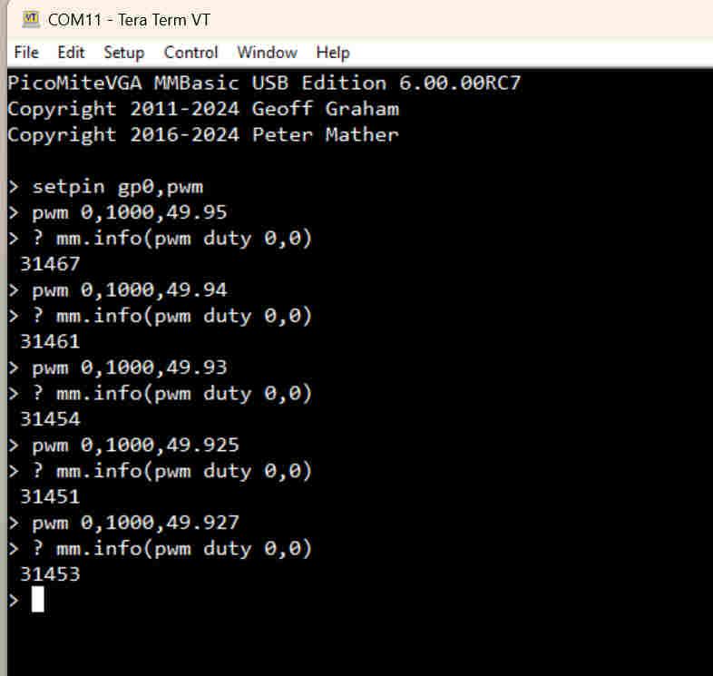

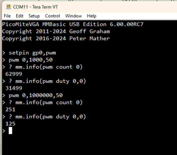

  Quote  . But we only have ~10bits, no matter the frequency, right?
I don't know where this has come from. The number of bits depends on frequency. Above CPU speed / 65536 it will start to drop but below that it will be between 15 and 16 bits.
You can see here that with a CPU frequency of 252MHz I have just under 8 bits of resolution at 1MHz but nearly 16 at 1KHz
MM.INFO(PWM COUNT slice) gives the total counts being used to generate the frequency
MM.INFO(PWM DUTY slice,channel) gives the counts at which the output transitions

Hi Pete.
But where you have 50% duty cycle = 31499, what if I want a smaller increment than 0.1%?
If the granularity is 0.1% then surely my effective range is 1000 (<10-bit)?
Posts: 10181
Posted: 11:08am 10 Oct 2024
What more do you want?

DOH!
I guess I was taking the one decimal as an indicator:
I thought my motor was running kinda great   Now I know why.
