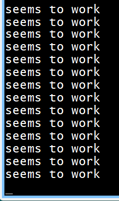

PhenixRising
Joined: 07/11/2023
Posts: 2096
Posted: 06:04pm 14 Oct 2024
Oh wait...this is too much FUN!
I wanted to do an OnTimer (settick) equivalent.
I don't subscribe to ChatGPT and so I exceeded my daily limit.
Decided to try Copilot for the first time which when asked, informed me that there was no limits for coding help.
So, it started-off with some crappy external library...all kinds of errors and so it said let's stick with the built-in functions. It kept getting the function names slightly wrong and so I would change them. It really was like working with an extremely patient human and the more I assisted, I swear, it got excited
Well we got there and I'm kinda happy that we had to jump through a few hoops because it was just FUN

PhenixRising
Joined: 07/11/2023
Posts: 2096
Posted: 12:46pm 15 Oct 2024
Well I guess "jumping through hoops" mystery solved.
My install is fresh and so I'd downloaded the latest (firmware? API?) ESP32 Arduino release. Quite a few things are no-longer compatible. just found this:
In response to @lbernstone and @Jason2866 , I will note that the Alpha2 version appears to have exposed issues with the following: I will attempt to be more precise in a future Issue post, but will close this now..
esp_now.h, (esp_now_register_recv_cb possibly defined in a different way to how V3 expects it?)
gpio.h ( issue with void gpio_matrix_in(uint32_t gpio, uint32_t signal_idx, bool inv); ?)
esp32-hal-timer.h (Seems to have different definitions of timerBegin , timerAlarmWrite timerAlarmEnable ?)
Those last 3 timer-related functions were giving me fits
Anyway, I ditched the version 3+ and installed the last of the Version 2 and now I can grab all kinds of ESP32 code and it runs without a fuss.
