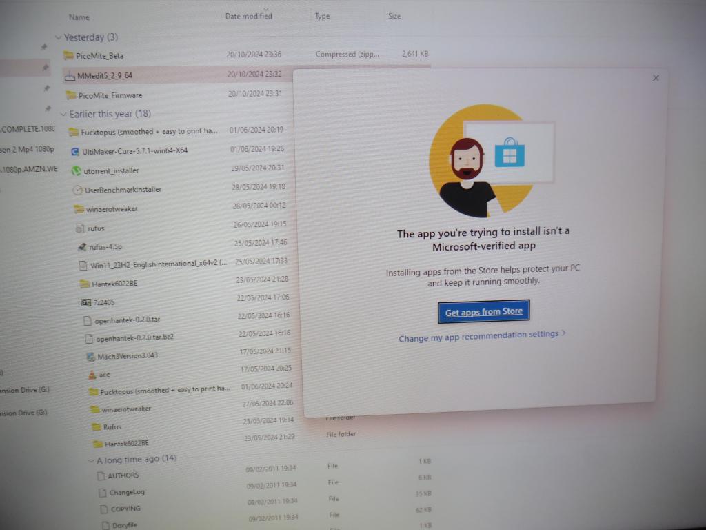

tried to install mmedit on another win 11 pc and it won't let me.. no options.
how ??

  stanleyella said  tried to install mmedit on another win 11 pc and it won't let me.. no options.
how ??
More information needed.
A screenshot of whatever appears when you try to install would be nice.
There are some deliberately nobbled W11 which restricts you to apps in the MS store. If that's the case, You can upgrade W11 to a real version or live without MMEdit.

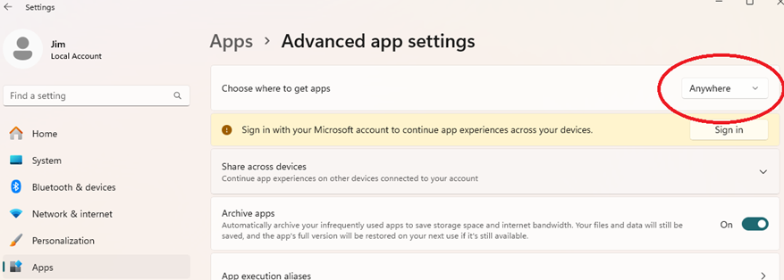

What happens when you click on:-
Change my app recommendation settings >
My guess is that will give you the option to install other apps.
Posts: 6572
Posted: 02:09am 21 Oct 2024
Posts: 2807
Posted: 05:04pm 21 Oct 2024
Thanks Jim, it's like win 10 now and mmedit installed ok. always mmedit fan since first use mmbasic. stan
and Phil you were right ,ta.
