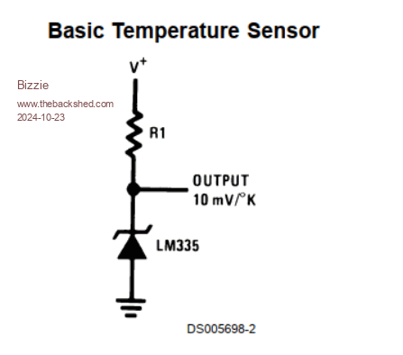

Had a request from my son, Dad can you make me some probes to measure temperature inside or should I say inbetween round bales in the hayshed ASAP.
I did not have any HTU21D's at hand so looked in the Jaycar catelogue and found my local store had some LM335's so went and bought 4.
I started to build a board with a 28 pin MicroMite with a 12k resisor as the datasheet indicated. During testing of the board I relised the MM would see 12v! if no sensor was connected or the sensor went open circuit. See below example circuit.
Has anyone used these safely? I can not use the HTU21D's as the sensor is on the end of 12m leads and works perfectly doing manual measurements.

You have a few options:
1.
a simple potential divider from the output to ground, Say 10:1 ratio and then scale up the readings in software,
2.
Feed the input into an op-amp set up as a buffer, with its supply at 3.2V Then if the input every goes higher then the output will just sit at the supply rail.
3.
Looking at the cct, it's a zener, so maybe a 3V zener at the MCU end to conduct if the voltage ever goes above 3v. I'm not sure how much that would affect the readings, depending on how high they get.

Surely the maximum temperature in the hay is going to be above 57 degrees?
57 degrees C = 330 degrees K = 3.3V
3.3V is the max that the micro can handle with analogue inputs so you are going to need some sort of preconditioning anyway.
I did use them in a hot house but found it reached the max too often.
edit: the DS18B20 would be my preference and it reads up to 125 degrees C

However as you already have the LM335s a 2:1 voltage divider across the LM335 (2 x 33kΩ perhaps) with a Schottky diode from AIN to +3.3V for open circuit protection.
Option 2. Replace R1 with a 1mA current source fed from 5V to 6.6V and once again a 2:1 divider.

The LM335 does *not* require 12V or a 12K resistor. The resistor value is chosen to put between 400µA and 5mA through the LM335 at the voltage and temperature you are using. The maximum voltage is 3.3V for the Micromite (limited by the ADC input).
At 3.3V the maximum temperature you can read is a bit less than 57°C.
The maximum value for the resistor at this voltage has to be less than 384Ω.

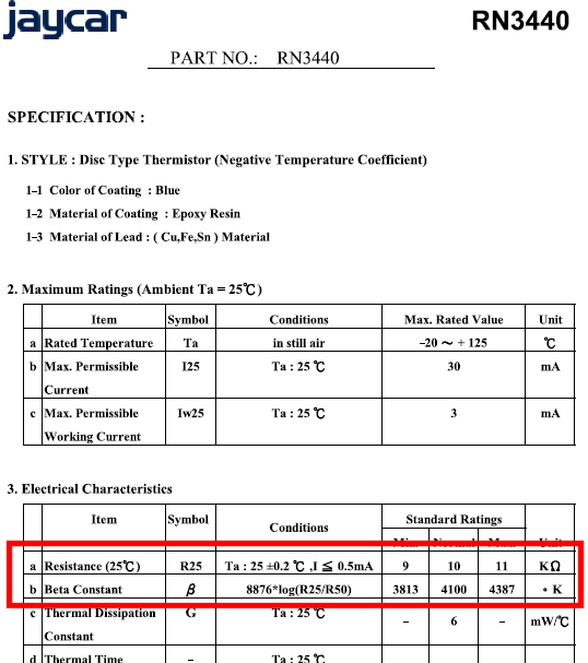

Hey Bizzie. Don't worry about current, you're going into a Hi-Z AIN and a KΩ+ resistor... thermistors play nice as part of a potential divider so it's just volts and ohms at the values we are using.
as @phill99 pointed out you need to know two things about your thermister:
1.Most thermistor resistances are stated as they are measured at 25°C - obvioulsy resistance changes with temperature so 25 was adopted as a fixed point in the range. Try to get one around R25=10KΩ
2. you'll need to know its "Beta" - don't worry too much about this, it's the fall-out of an equation and allows you to estimate the °/Ω curve without some horrible complex maths, good enough for most applications. Every supplier will show this in the datasheet.
So, considering the following measurement circuit (only the thermistor is exposed to heat)...
... When I was playing with them, I found the following:
trying to get Vtb=1.65V, i.e. middle of the voltage range (and so Rt=Rb - a straightforward 50/50 divider)
with Rb=1K, Temp was 83°C
with Rb=2K2, Temp was 59°C
and with Rb=4K7, Temp was 39°C
In your place (and assuming you have the same Beta - or near it) I would go for Rb=2.2K. This means that when you get 1.65V at Vtb, the thermistor is ≈59°C.

so looking at the datasheet for the JayCar part RN3440,
it looks ideal (R25=10K, Beta=4100). Grab a load and make up a loom with tons of these - 12m of wire won't significantly affect the resistance of the thermistor at these currents.
