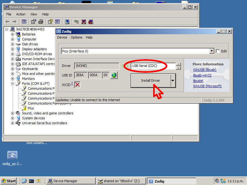

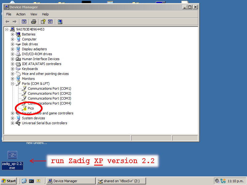

I have downloaded MMEdit (portable) for my XP machine but I have never used the Pico on XP. Device manager just shows "Pico ?"

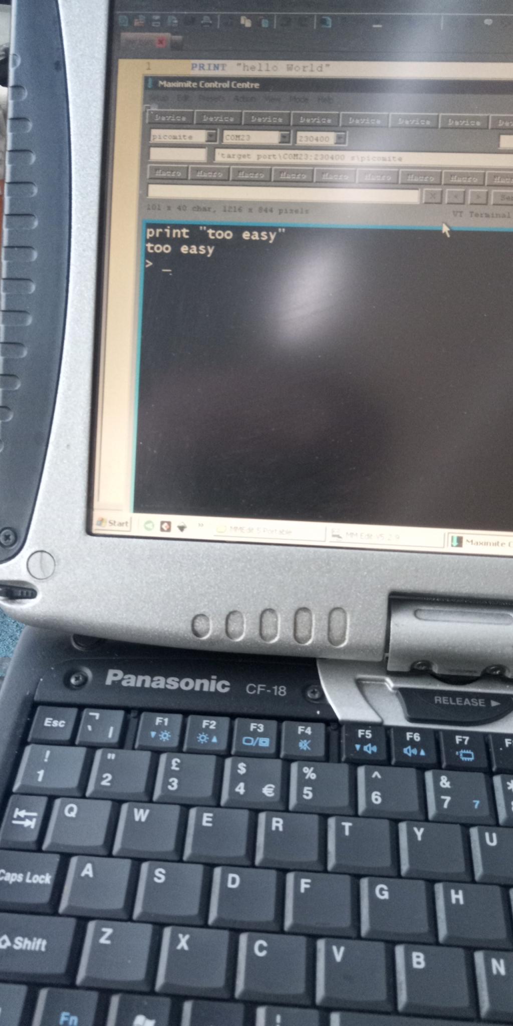

I use a Panasonic Toughbook CF18 on the plant-floor and it has been rock-solid for years. Very low-powered and I didn't wanna risk trying to install W7.

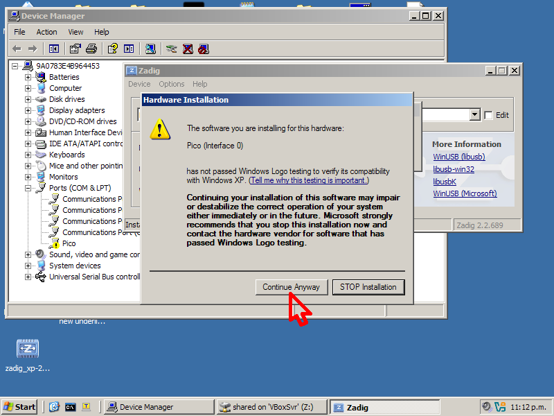

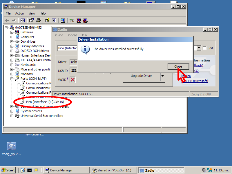

to answer Michael's initial question, download Zadig XP version 2.2 from here:
https://zadig.akeo.ie/downloads/
and then follow these slides:
note in the second slide to select USB Serial (CDC) in the dropdown.
rob   :-)

OMG....that must've taken all of two minutes
Many, many thanks, Rob
