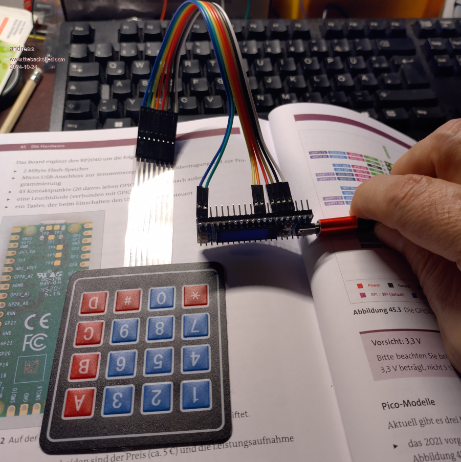

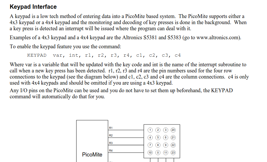

PicoMite User Manual MMBASIC Ver 5.08.00 page 42
In the example for the use of the KEYPAD command there is the keyword DEVICE as prefix missing.
Example:
' keypad
Device KEYPAD Taste,myint,GP2,GP3,GP4,GP5,GP6,GP7,GP14,GP15
Sub myint()
 Print "Taste = " Taste
End Sub
 Pause 1000
End
-andreas
Posts: 3369
Posted: 12:02am 24 Oct 2024
Thanks, will fix.
