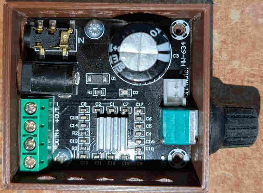

12V barrel jack power and the output seems pretty immune from noise on the supply. Quoted as 15W per channel. Take that with a pinch of salt but still plenty of oomph with no obvious distortion. 3.5mm stereo jack input and screw terminals for the speakers. Works like a treat on the pico using volhout's magic filter.
This is the module
and here is the stl for the box 52mm x 48mm x 30mm
ampbox.zip

Extortionate price, of course. :)
Your ears will love you if you stick to a maximum of 8W per channel into 8Ω with a 12V supply, giving 0.1% THD. That is soddin' loud in the average living room though. :)

Look at AliExpress for even cheaper prices. Already seen under 3 Euro including shipping costs.
Has excellent specifications.
Power at 12V DC
    5W 8Ω --> THD+N=0.1%
    8W 8Ω --> THD+N=1.0%
   10W 8Ω --> THD+N=10%
   15W 4Ω --> THD+N=0.1%
   Efficiency: >90%
It says here that it is a 2x10W with this configuration and if a larger heat sink is used, 2x15W.
Also nice to use the extra connections such as mute and the power switch.
