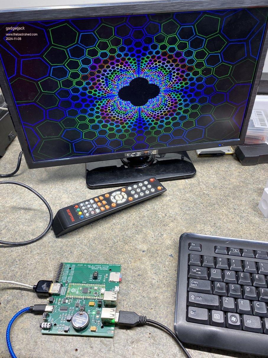

Just got the board in the mail today (Big thanks to Carl for the board). No problem soldering the pico2 on the board at all. Just followed all the great tips. It worked perfect at first boot.

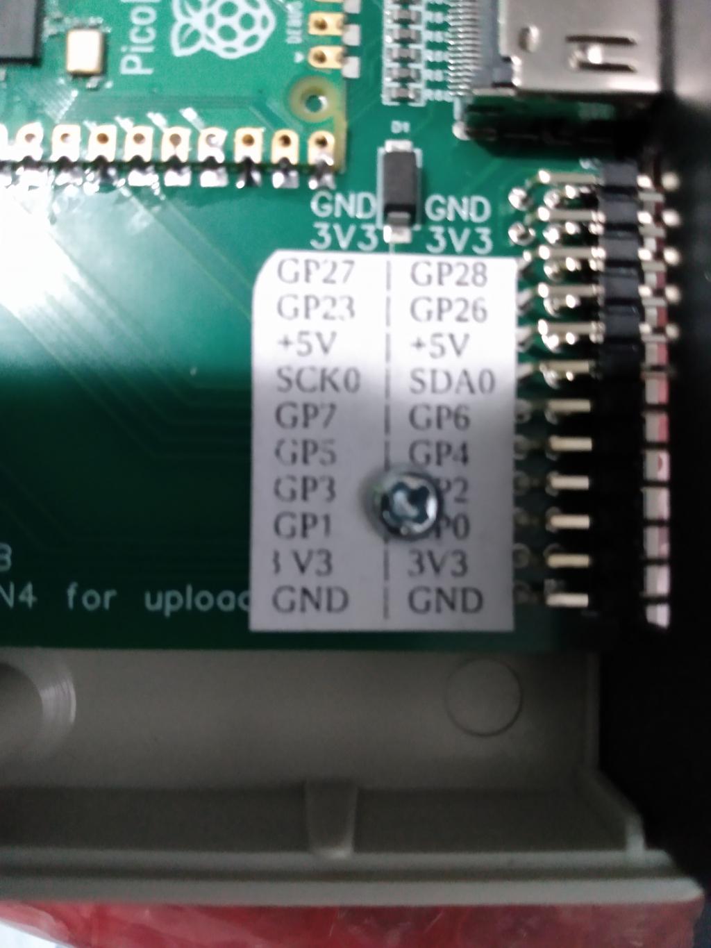

Looks Great!  I see that I forgot to apply the label correcting the silkscreen for the GPIO.  The silkscreen for the GPIO pins is correct on the bottom of the board, but the pin ID's are reversed on the top.  I have some labels printed and I can drop one in the mail for you.
Note this is board V1.0, Peter has corrected the silkscreen in later revisions of this board, so if you are ordering, be sure you download the latest version.
Here are the correct pin Id's for the top:
Here is the document I created with the pin labels.  I used some "Avery 8163" mailing labels that I had on hand, but could easily be reformatted for others:
GPIOLabels.zip
