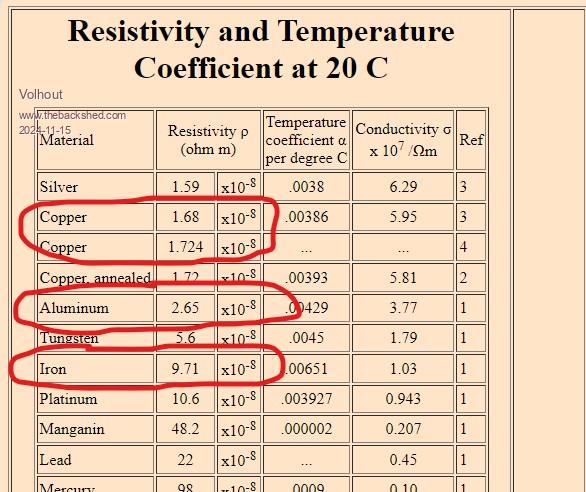

Posted: 09:22am 15 Nov 2024
Hi,
Aluminum is fine, it is only 1.5x higher resistance.
Iron is bad, it is 6-7x the resistance of copper.
